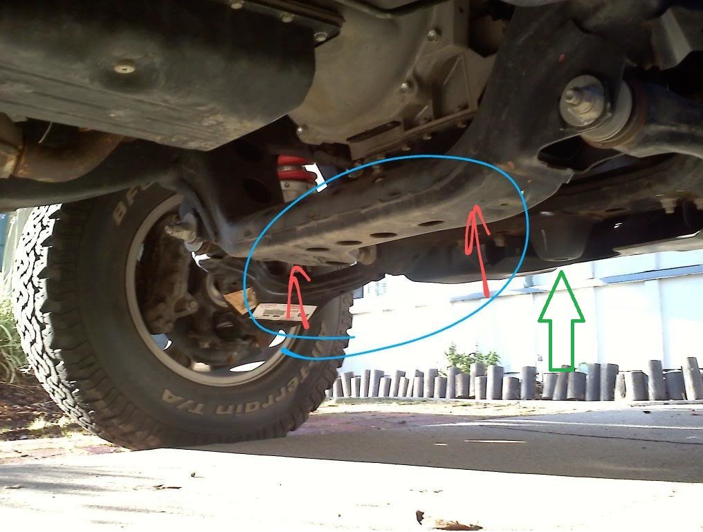

    bentcorssmember2_47b2f3ecbbb301578b1778bb114e017b97d77bc7~2.jpg look @ pic.... is it really safe to jack up the truck from cross member? borrowed pic from another post. like when you get a flat tire.
    btw... I'm specifically referring to that not the other lift points...

    yes im aware....asking about pictured area.... seen other people post that they can lift their never been too secure about that area

    I've done it, no issues just to change a tire.
    But I wouldn't work under the truck unless it was on legitimate jack STANDS.

    I lift it from there all the time.
    Edit: don’t lift it from there.

    so what do you guys think that Toyota never included that area as a lift point with the exceptions of the holes and the crossmember

    Yeah, I would think if you’re in a situation where thats all you have would be okay ~ with some of the above statements, but for other ideal applications wouldn’t seem necessary if you have access to for ideal jack points.

    What about that little bump thing lol

    I use the bump thing on my 2009.

    Can you show me proof it can cave in?

    woah, was that a jack or from off-roading? I won’t be using that area anymore!

    The bump is 100% a lift point, I would never lift from that rear cross member.
    I always lifted from the front bump or from the control arms when I use a jack.

    Absolutely not, not only would it not be stable but I have dented that from jacking.

    Impact load is WAY more force than statically loading with a jack.
    Yeah that metal is thin but it has no issue sustaining a static load, dropping on it offroad onto a pointed rock or other obstacle is MANY times the force the truck can exert sitting still with no moment. When you're talking about 4k pounds even a few inches can result in exponential force applied.

    Yeah agreed there, I usually jack up by my 3/16 plate skid belly armour but I have jacked by the cross member there before just to get it high enough to put a stand under it.
    Same things with hi-lifts, use it when you need to but realize it's sketch and know your danger zones (such as underneath) and stay out of there.
    When on the trail if you have to do really sketchy shit and be under the truck use your spare as a fail safe.
