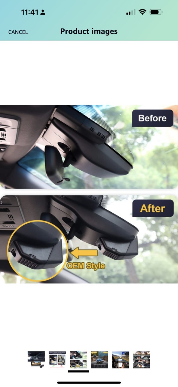

    IMG_0301.png While searching TW I found the FitcamX that replaces the stock cover of the TSS.
    https://amzn.to/440EkZq
    Haven’t pulled the trigger yet though.

    Yes I did purchase the Dongar technologies with intentions of a Garmin 57 or mini 2. Came across the Fit Cam X. Installed very quick all cable and hookups in box. So far so GooD. Clean OEM look.

    Thanks to Phenom 3030 and Bozojuice I took a look at the Fit Cam X. Very interested after just a little research. FYI if you want want parking mode, they offer a cable ($40) to provide continuous power.
