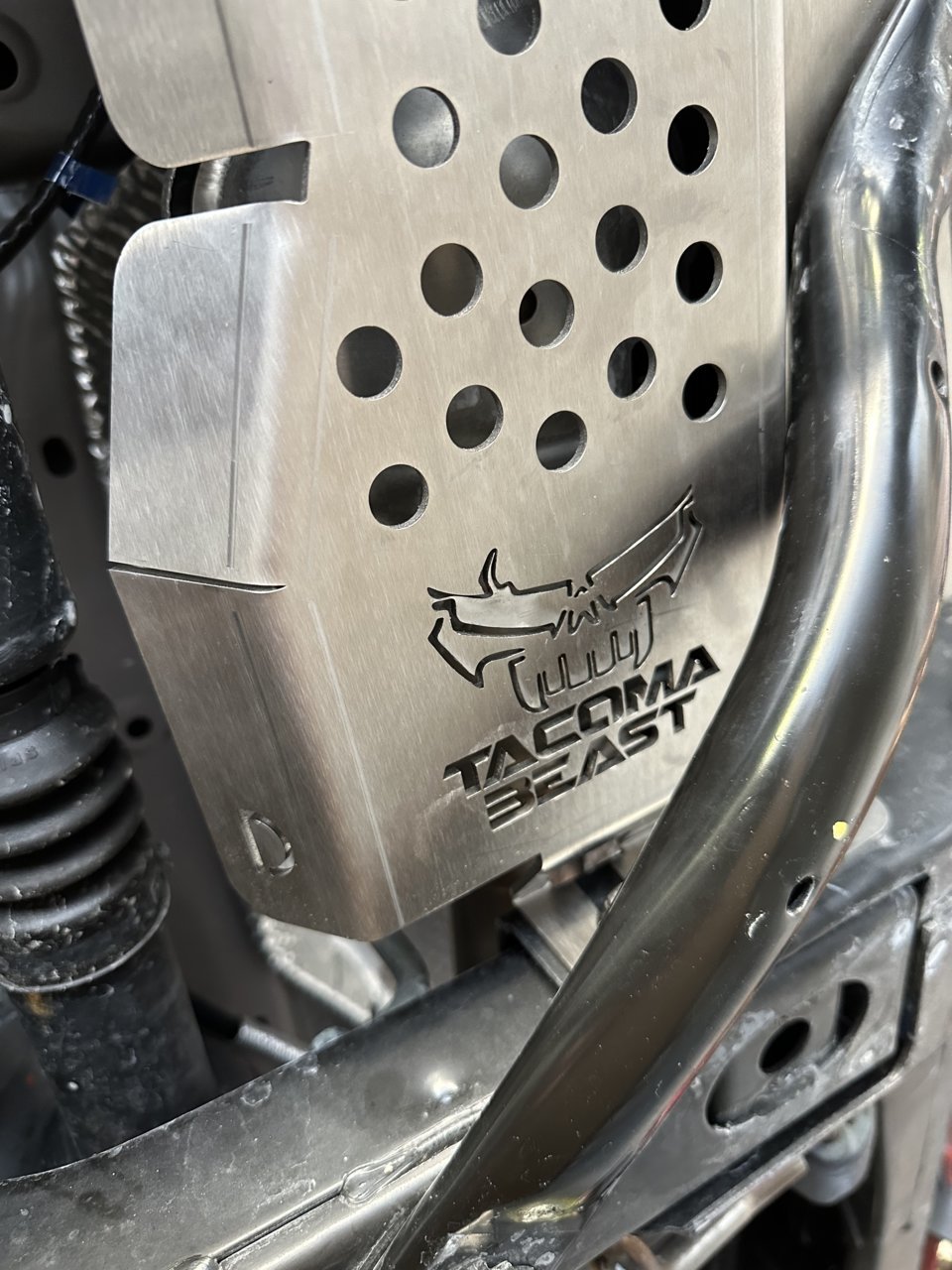

    Anyone have an issue with the caliraised cat shields contacting the black support bars? The shields are pushed up as high as they can go and there is no way to make them not touch.

    Hammer, or maybe loosen the support bars and then see if there is any room for adjustment on them and re tighten.

    I used the millercat. No issues no noise. But like the others said…. Only one way to fix that contact. Massage it with a dead blow hammer

    When i installed my rci transmission skid with cat guards, I had to remove those support bars. It said it was not needed.

    I just put mine on yesterday. Mine are touching in the same spot as well. I didn't think is was that big of a deal. I haven't driven the truck much, but heard no sounds on my after install test drive. I even drove like I stole it for a few turns...

    If it rattles, maybe put some duck tape on the contact points.

    I’d just mark them at that area then grind off a bit of the shield so there is no contact. If it’s not making noise though, let it ride.

    Thank you everyone for the feedback. no rattles or noise so far. i'll let it ride for now and see what happens

    If the guard is aluminum there will eventually be galvanic corrosion. Just be aware of that.

    It's a non issue. Both the shield and support bolt to the same frame. Your support is touching and sandwiching the shield just inches away from where you're worried about contact.
    I have the original version and it touches the drivers side cat. The exhaust is rubber mounted and can move independently frome the frame and shield and that hasn't even been an issue.
