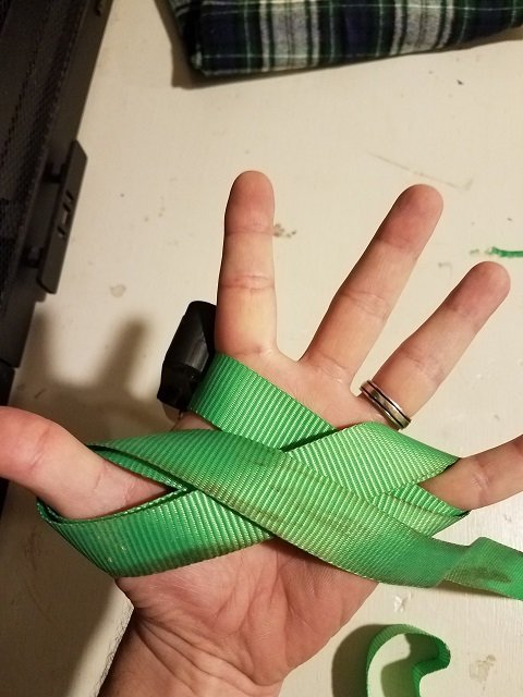

    I do a figure eight with them (this takes far longer to explain than to actually do)
    1. Yay! the rat nest:
    2. Pull the loose tail all the way through in order to bring the hook up against the ratchet, then fold the ratchet closed into the locked position:
    3. In your left hand, hang the ratchet handle and hooks between your thumb and index finger with the loose tail running between your wrist and pinkie finger:
    4. Run the loose tail around the back of your pinkie finger, over the strap lying on your palm, between your thumb and wrist, around the backside of your thumb and back over where you started. Avoid twisting the strap, you want it to lie flat:
    5. Repeat #4 til you have a tail that's approx 10" or so left (longer for wider straps, this is a 1" strap).
    6. Carefully slip your thumb and index finger out of the loops while holding the center of your figure eights. It's helpful (but not necessary) if you can set the ratchet on something like a table, tailgate, etc. Wrap the loose tail twice around the center of the figure 8 at least twice. After the second wrap, pass the loose tail up through one of the loops:
    7. Pass the loose tail down through the other loop. You can do repeat this if you've got a lot of tail left. When you're down to the last few inches, pass the tail back through the first couple of wraps around the center of the figure 8 that you did in step 6 and pull it snug:
    8: Done. The wrap should stay together without too much trouble. When it's time to use it, just undo the last couple of wraps from steps 6 & 7, the figure 8 should fall apart with no tangling.
    This method works well for cam straps too (just start at step 3) because you can run the loose tail back through the cam and it really won't come undone before you need it.
