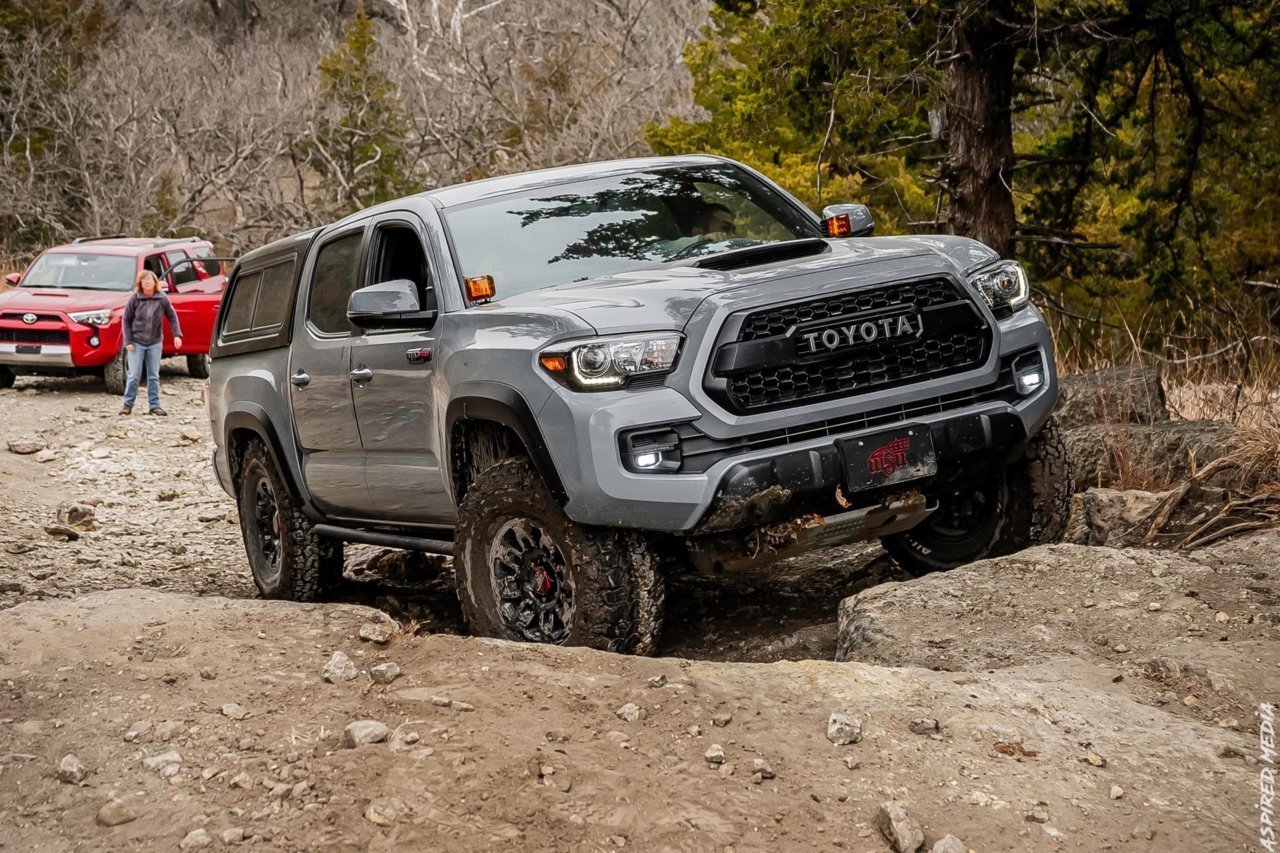

    Ford F350, Lexus RX450h, FZJ80, Jeep YJ, Jeep LJ
    @AccuTune Offroad Thoughts?
    Why? You dont need LT to run 35s and the 3.5 is fine, regearing is always necessary when running larger tires. I don't see any Samurai guys complaining about their 120hp 1.3L engine turning 35s and 37s
    Considering that most people work M-F, quite literally every single vehicle here is a "weekend wheeler." I just ran Chinaman Gulch this past weekend and a basic OME kit would have made it miserable...
