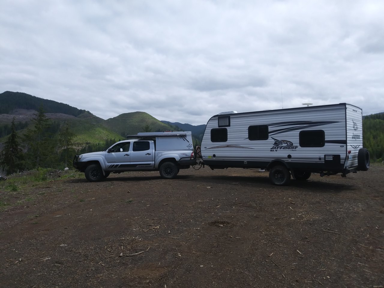

    Here's a 17 foot trailer I've towed twice for a friend. Even a 15 footer is BIG compared to Tacoma. I towed it with a V6 2nd gen and it wasn't something I'd want to do on a regular basis. Being a single axle, it also wanders a lot more than my double axle flat deck trailer.
