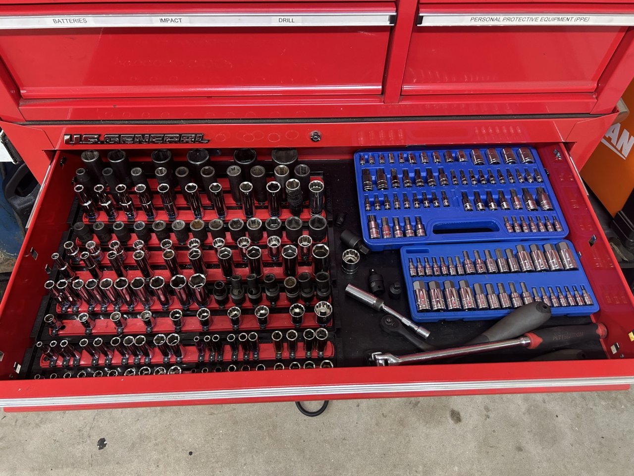

    I'll agree with others and say nope. 3/8 would be fine on anything interior or accessories you're adding, but doing any sort of suspension work and some under the hood work you'll need 1/2". When I finally got a proper toolbox I went a bit nuts on my socket drawer but damn it is nice having it all organized as well as 1/4", 3/8" and 1/2" drive in every size.
