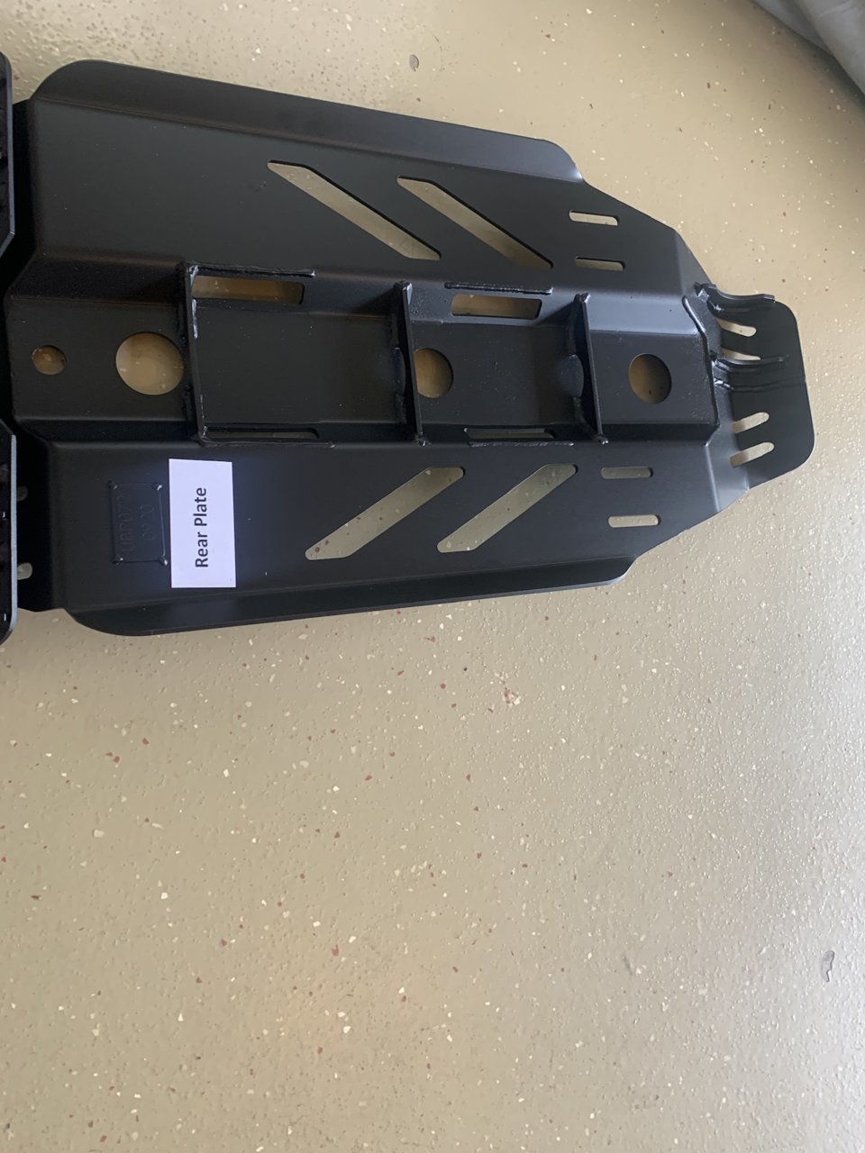

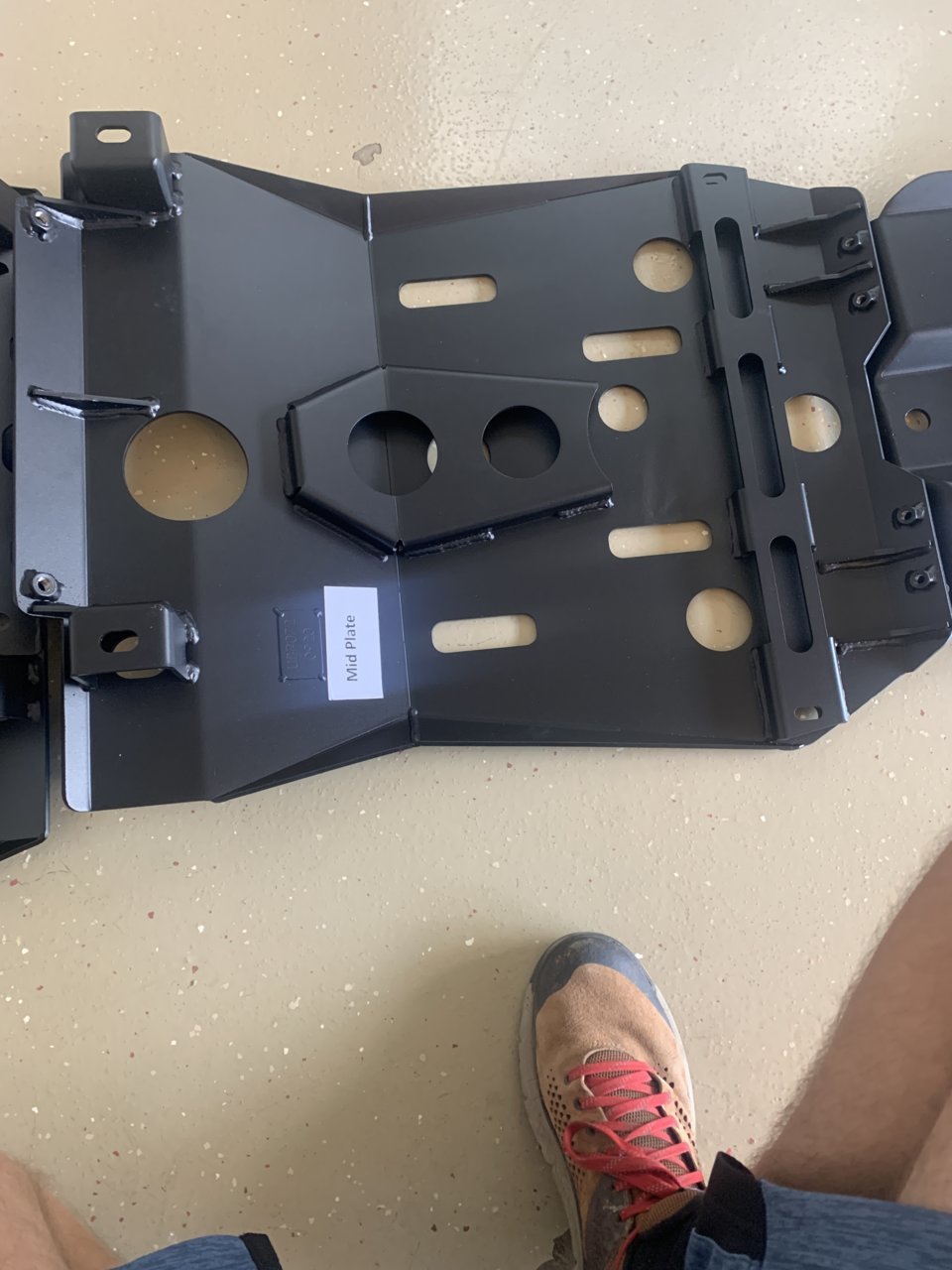

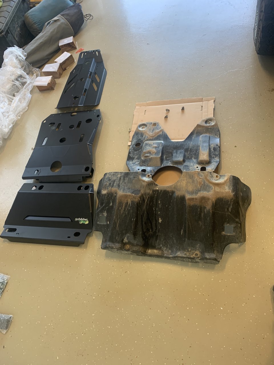

    I just got them a few weeks ago. Happy so far. They are very well built and seem to be well engineered with good reinforcements on the back(means they can use thinner metal but retain the same or more strength as thicker ones that are just plate to save weight). Install was easy, everything fit together as intended.
    The only thing I don’t like is that they don’t extend far enough back to protect the transfer, they end right under the exhaust crossover.
    If people want a review I can post one eventually. I have been on the trails since install but never contacted anything with the mom yet. Don’t see any value in reviewing skids before they’ve taken some good hits. It’ll happen soon I’m sure as you could guess from the condition my stock ones were in.

    From the pictures they don’t offer the same coverage as other companies, much less. Don’t have panels for oil changes. They aren’t gusseted in the appropriate areas to provide adequate protection from hits.
    I would consider these a light duty option for those who don’t really need skids.

    Agree that the lack of TCase coverage is disappointing. Otherwise the coverage is good. Maybe others are wider but they’re protecting nothing with the width, everything vulnerable is covered. Also not sure what you think’s wrong with the gussets, they already have a more angular design than others and the gussets are in the appropriate spots to strengthen those.

    Ya the wider plates usually offer additional coverage of the LCA cam bolts preventing them from getting wrecked but you can always by additional gussets to strengthen those up.
    As far as the skid gussets, the front has framing on the edges but lacks anything in the middle. Not a deal breaker but I hit that spot a lot. The mid skid only has a small gusset in the middle. If you compare that to Mobtown they gusset the entire skid.

    I think your scales off. Keep in mind that because they don’t extend as far back my plates are shorter than you think, use the hole for the jack point as reference.
    The engineering is honestly really solid. I found a picture of the mobtowns and I trust this more. It has structural bends in all the key spots, that big gusset on an angle adds a massive amount strength, the mobtown mid plate is supported by the front while the Ironman is supported by the chassis and the front plate(which itself bolts to the chassis front and rear). Structural bends in the right places can do a ton for strengthening
    We’ll see when they get put to the test for sure but I definitely think they’re well engineered.

    Mobtowns bolts directly to the crossmember of the chassis.
    To each their own. I’ve damage enough and even broken enough skid plates to choose what will work or not.
