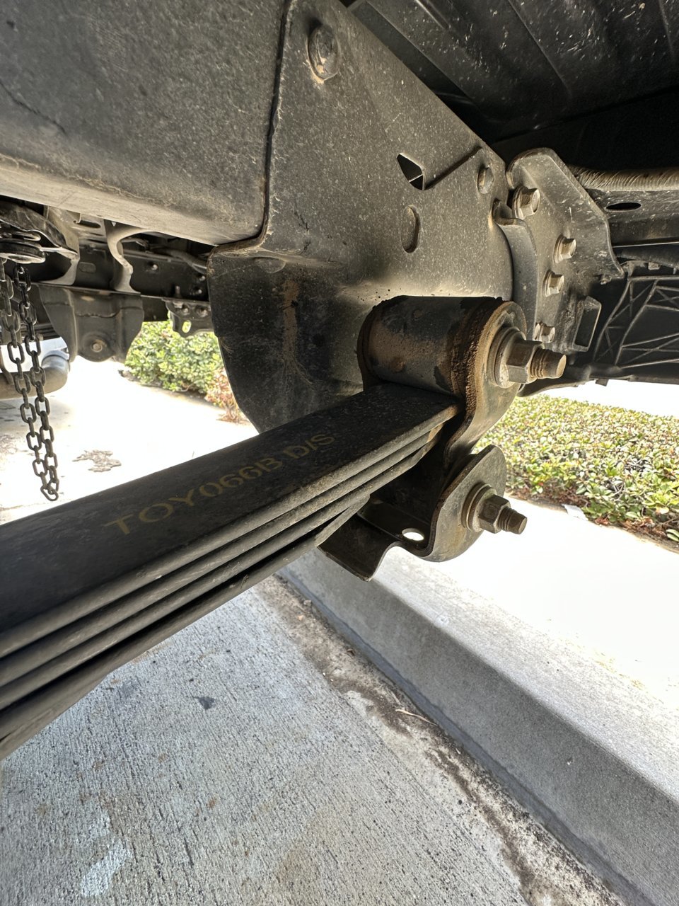

    I actually just checked my whole lift kit since I've driven about 2000 miles now (just over a month), and discovered this.
    Brake line is rubbing on the bolt from the leaf pack wearing into the brake cable & the bolt is rusting already.
    Are you or anyone else with Ironman leaf pack have this issue?
