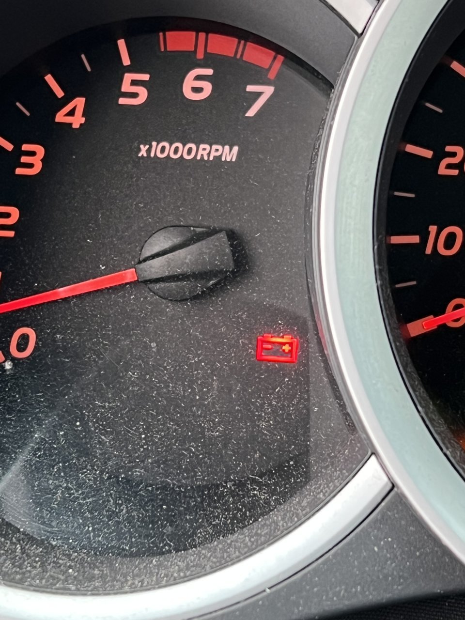

    My truck suddenly didn’t start a few times and I needed a jump a month ago. Second time it wouldn’t even start off a jump from a full size truck. Changed battery which was a 4 year old interstate and cleaned all connections. No issues for about a week. Went to start it and heard a weird hum from engine compartment and battery light came on, but it started fine. Battery light went off during the drive and didn’t return for 2-3 weeks (today). Remote started my truck and it shut off then auto Re attempted and started fine but battery light is on again. 3 weeks ago when battery light came on after installing a new battery I had alternator tested at O’Reilly and they said it tested ok and battery tested ok. I’m at a loss now. Not sure if it’s the alternator or someone said my serpentine belt could be causing this. I’m definitely overdue for serpentine belt change and belt does seem to chirp a bit when I start truck rainy days or high humidity mornings. How would belt be the cause?
    Any ideas?

    Maybe the aftermarket remote start is having an issue
    Check all frame and engine grounds for corrosion and tightness
    Just because the parts store said the alt was fine doesn't mean it is. It could be failing intermittently

    Check voltages at the battery, and the alternator.
    My guess is your alternator is waving the white flag to retire.
    If you are going to replace the alternator might as well swap the belt since you gotta un-tension it anyway.

    what's the voltage reading at the battery with the engine running?

    I believe it was 13.6 volts

    That's an indicator that your alternator is on its way out. You want it reading 14.0-14.5v to indicate a properly working alternator and/or a strong battery.
    The current alternator is doing a weak job of charging the battery and some of the truck's accessories are draining the battery down when not in use.

    2nd gens don't charge at that high of voltage, mine runs 13.2-14.2 typically depending on temperature. The best on vehicle test is to turn all the loads on (headlights on high, blower on high, etc) and make sure it stays above 13v.

    Driving home ABS/BRAKE light just came on, LSD light and stereo shut off and won’t turn on. I’d say I have a battery charging problem lmao

    Agreed, 13.6 voltage output is normal for 2nd gen Tacos. The lit battery light can be caused by one of several issues:
    loose/dirty alt connections
    dirty/loose frame/motor negative battery connections
    bad tensioner
    weak/bad battery
    weak/bad alternator
    A bad belt is unlikely unless it is super glazed which would cause slippage.
    I would put a plug-in volt meter in a power port and monitor voltage levels as you drive about.
    If the truck has over 150K, I would be replacing the alt as preventive maintenance. I did that and kept the oem alt as a backup. I got a BNR alt, they are an eBay vendor. I also got one for daughter’s 07 Corolla. Both have been running well for about five years now.

    Never ignore the intermittent battery light!
    From my experience, a weak alternator can wear out a battery or vice-versa. I had to replace both after being stranded in the middle of nowhere in the middle of the night.
