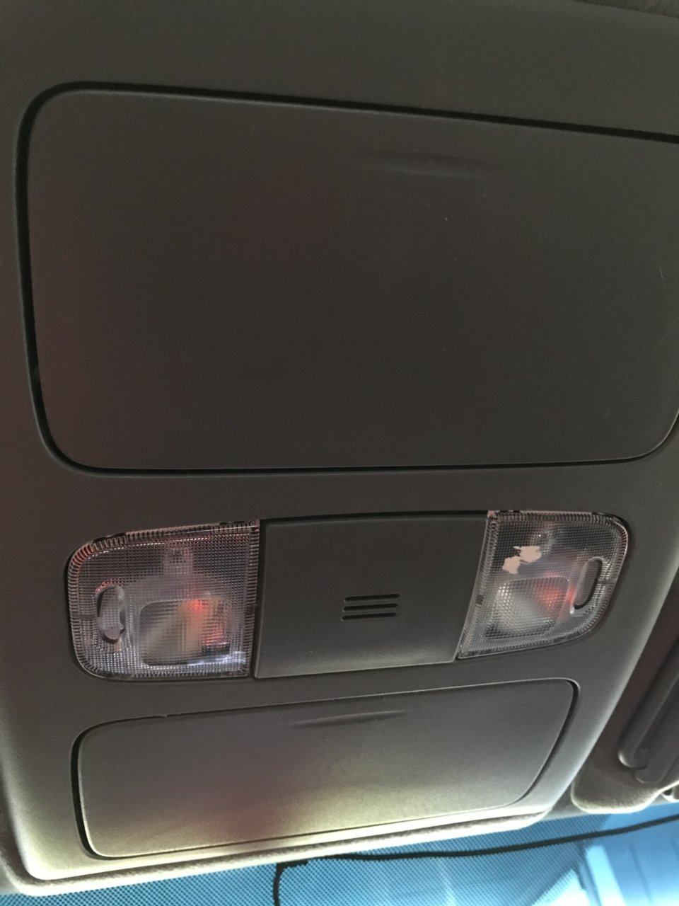

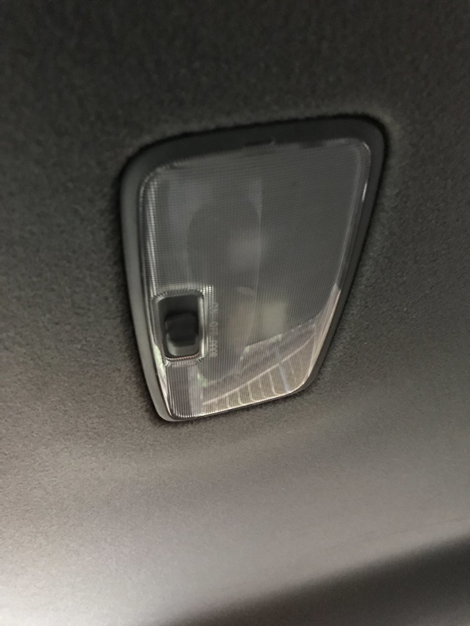

    DAA5113A-7636-4238-8F98-E76EF895983D.jpg 6DFB1AA7-0881-44D6-A7AE-A066CDEFB6A9.jpg Last night, I installed my newly ordered interior LED light kit from Tacomabeast. I followed the instructions to the “T” and now both the interior lights (map light and dome light) don’t turn on. Could the issue be a blown fuse or something, if so where is the fuse box on a 2014 Tacoma? Thanks

    The fuse is labelled DOME and should be 7.5 Amp Rated. In the fuse panel under the hood.
    Supplies both Dome and map Lights.

    *update* so I replaced the fuse and now only my dome light is working not the map lights

    Pull the fuse, remove the map lights, rotate them 180 degrees, and reinstall.

    *update* ok just wanna thank everyone for your help. I got the lights to work after just replacing the fuse and switching the map lights.
