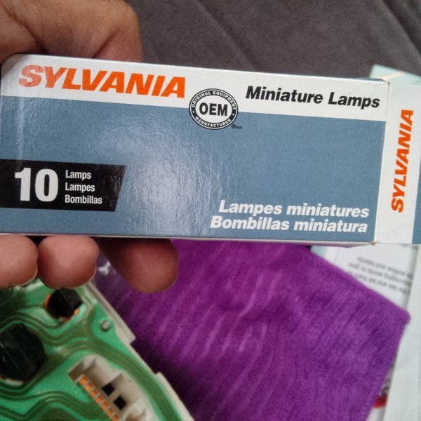

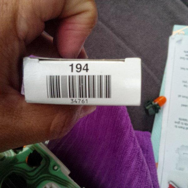

    There are quite a few threads on this topic already. Give me a sec for the link. Your 4wd light is probably just burnt out and need replaced. You are correct on the 194 bulb size for the cluster.

    Here more pics

    The indicator bulbs are a #74 bulb socket size and are all the same minus the 4 194's
