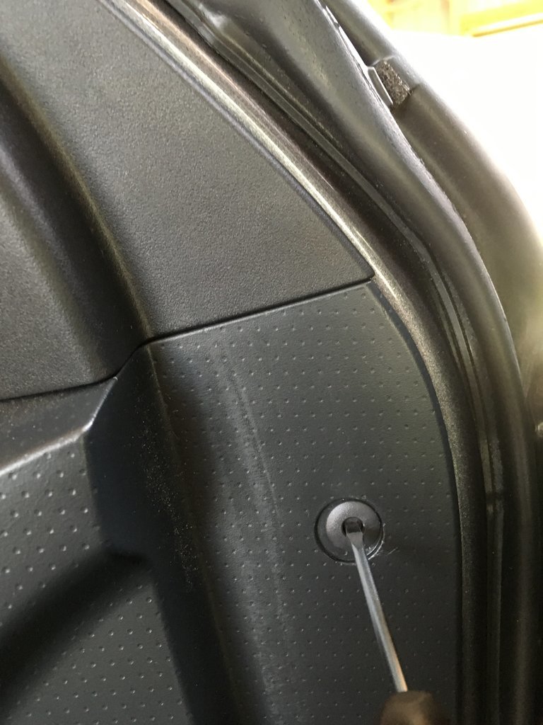

    Just a few details on this, in case you haven't done it before. The pics really only highlight the fastener locations. Once all the fasteners are out (4 total: 3 screws and a plastic retainer), pull the door panel off. There's a good place to grab ahold of it near the front-bottom area, and give it a tug. I would highly recommend some plastic trim tools to start prying from the bottom edge of the panel.

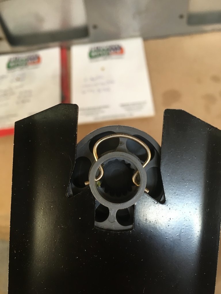

    Plastic retainer: push the center of this retainer in to release it, and it should then pull out easily. Before reinstalling this, push the engagement pin back out as shown.

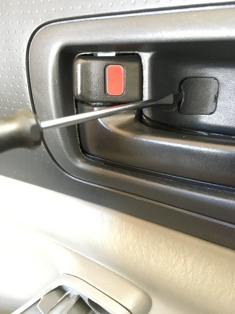

    Now remove the 2 screws from behind the door handle. Pry from the access point shown here. After removal, the door panel itself should be ready to remove.

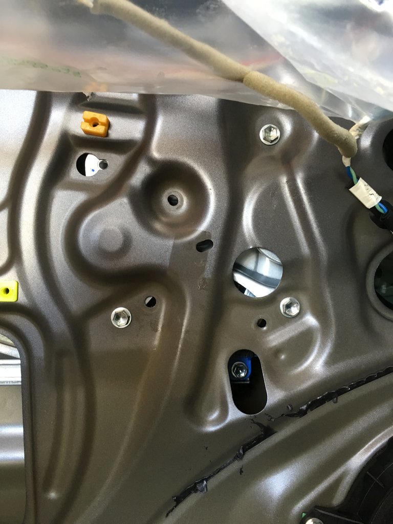

    Now carefully pull back the plastic that covers the door. It's stuck down with some seriously sticky mastic, so some force is necessary. Just take your time and be careful to not stretch or tear the plastic more than absolutely necessary. It does not need to be fully removed, just peeled back enough to access the window regulator bolts.

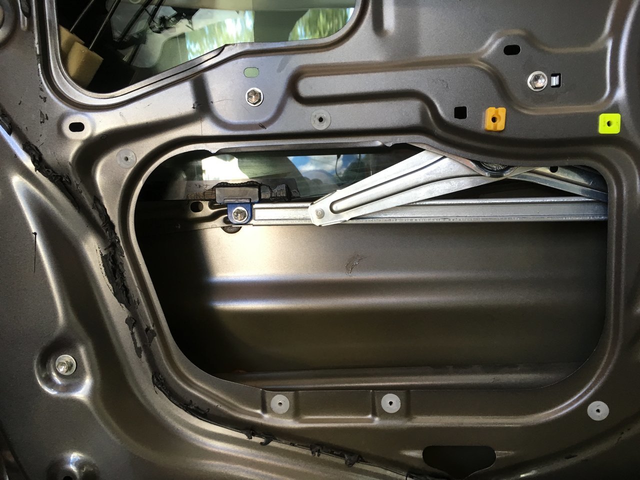

    With that out of the way, lower your window until you see the bottom window support rail bolts thru the access hole in the door:
    First, remove the 2 bolts that attach the bottom edge of the window. I did this entire job by myself, but it would be really helpful to have a 2nd set of hands here. With the window detached from the regulator, you'll need to pull it up out of the way, and either use some really good suction cups to hold it up, or use a piece of wood wedged up from the access hole. This wasn't a great method, but it worked.

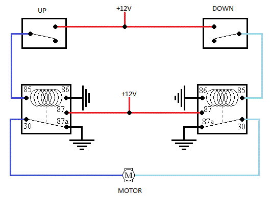

    Study the 2 schematics until they make sense to you, as it really helps to understand exactly how this setup works. Both schematics are almost the same, the only difference being that on one, pushing the button supplies one leg of the relay with +12v (the other relay leg is grounded), and the other one, pushing the button completes a ground circuit to the relay (the other relay leg being +12v). The grounded switch method is the one I used, for no particular reason other than I felt it was easier to wire that way. Without going into too much basic electricity detail, you will notice that both legs of the motor 'rest' at ground. When 1 relay is energized, it removes ground and feeds +12v, so the motor is now powered. When the other relay is energized, the same thing takes place, on the other leg of the motor. Hence forward/reverse motor action.

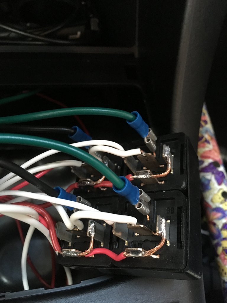

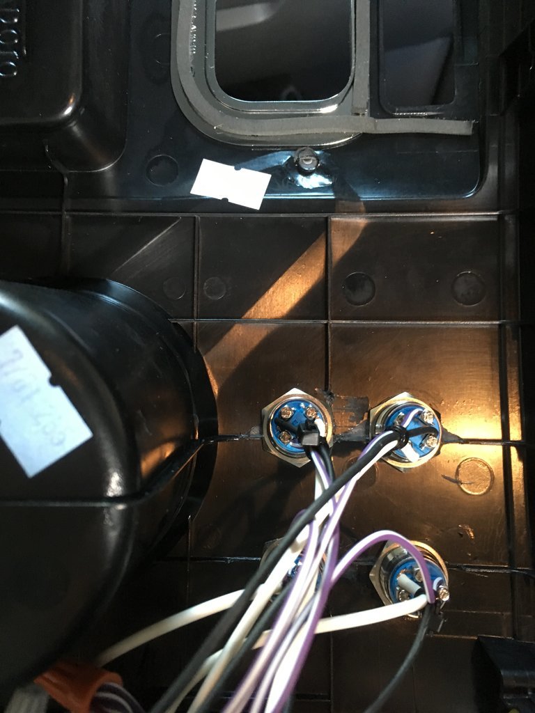

    You can do your relays however you wish, I opted to construct a relay pack, keeping all 4 together. I soldered most of the connections, although I used the spade connectors with the motor wires. You can use relay sockets or use all spade connectors if you wish. Just make sure your connections are clean and solid. Relay sockets would be the preferred method, IMHO. And I will probably revisit this some day and redo it using them. For where the relay pack is located, it didn't require a lot of taping up, as it's all plastic around it, nothing to short out on.
    The center console cover is retained by 6 tabs, 3 on each side. Carefully pry it straight up from the bottom, and pull it over the shift lever (takes some doing). Remove the front cup holder inserts, and pull the cup holder compartment straight up to remove.

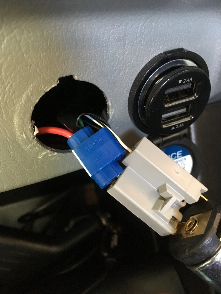

    After poking & prodding the fuse box for some time, and realizing that the PW fuse locations were apparently not 'hot', I opted to grab power from the 'Power' outlet in the dash. Removal of this socket and tapping the power wire as shown. I had to pull rather firmly to get enough of the harness thru far enough to tap the connection. Fishing the wire from the power port to under the console was a chore.

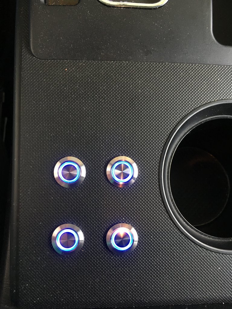

    The final installation looks like this:
