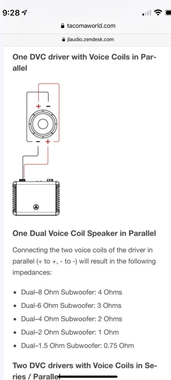

    I found out I have the D4. So does this mean I wire for 2 ohm or 8?

    Is my amp to powerful for my sub at 2 ohms? Is now the question lol

    That means you can ONLY wire it to 2ohm or 8ohm. Your amp is rated at 500 watts at 2ohm, but your sub says 400 watts RMS. So, your amp could theoretically be putting out more wattage than your sub can handle.
    I would assume there is a way to counteract this wattage overage, but I can’t say for sure how to achieve it. Maybe when setting the gain on your amp you just don’t set it to the maximum level like normal? I really don’t know.
    However, maybe someone else on here can weigh in on that.
    With that said, you’ll want to wire it like the picture below to achieve 2ohm.
    Amanhowzit taco[OP] likes this.

    Okay let’s see if someone weighs in. I found this on google.. maybe 2 ohms is okay as long as I don’t boost the bass or volume?

    What posts are you waiting on? Like terminal posts to bolt into the enclosure? Just pop a hole slightly larger than the wire you'll be using, run the wire through, and seal it. Maybe put that somewhere you can put posts later if you don't like that route. 14 ga wire is more than enough.
    You'd be OK with a 2 ohm load, but you would void your sub's warranty. Then again, it seems like you're pretty new at this, so underpowering the sub might not be a bad thing. Maybe start with 8 (series). You can always change it later. Most that are really into the hobby overamp, myself included, but maybe you should save that for down the road :thumbsup:

    You also don't need to use/wire in both voice coils on the sub. You can use one and it'll work fine.
    Having more power available than what the speaker is rated for is only an issue if you're cranking it hard.
    Connecting speakers with a lower than minimum stated impedance to the amp will cause overheating and eventually blow it up as it were.

    What he said. It’s not optimal but DVC subs for car audio are meant to give you three options for final impedance, half or double when connected together, or you can simply use one of the voice coils to get the rated value of one coil, but basically it means you bought the wrong sub if you are forced to do that. The Thiele Small values change depending on how you connect it as well, so this should be a consideration when selecting your subs.
    There are other ways to connect DVC subs that are never used, like shorting or putting a resister across the second coil to change damping.
    Generally you should work out your power and impedance before acquiring your sub driver(s) so you don’t end up in this position.

    After reading your and Larrzz reply 3 times I understand what you both are saying. I am
    New to this and now I feel a lot more confident with the install. Thankyou all for that.
    Here is my thoughts after reading your reply’s.
    More power is better but I probably should have picked a more optimal amp for this sub. Especially since going to 2 ohms voids the warranty. Soo it sounds like there is risks with this sub going either way 2 or 8 ohms, unless of course I get a different amp. I don’t want to do what larzz said will happen at 8 ohms so I will run it at 2 ohms. I have a bass
    Knob as well and won’t overdo it and try and go easy on the sub.

    What I said was just the opposite. A 2 ohm speaker load will damage the amp whereas am 8 ohm speaker won't.
    The 2 ohm speaker will generate higher levels of sound at the expense of the amplifier being overworked, which will cause it problems.
    The 8 ohm speaker won't go as loud as the 2 ohm speaker, but the amp will be much happier driving an 8 ohm load vs a 2 ohm load

    All you need to do is limit the output of the amplifier when you set the input sensitivity. 28.3VAC is your target output voltage for 400W @ 2 Ohms.

    Yeah, I was saying wire straight to the sub without posts or terminals. Yeah, hot glue could work well. So can good caulk or wood glue mixed with sawdust.
    I was actually suggesting you wire in series and stick with 8 ohms for lower power output seeing how you're new to this. That avoids voiding your subwoofer's warranty also. Not because you wired it in parallel for a 2 ohm load, but because the amp is rated at 500W at 2 ohms and the sub is rated at 400W. Over at JL that voids the warranty.
