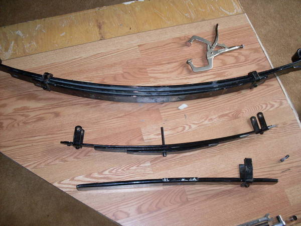

    I agree with 2006J, I had to remove the stock leaf pack retaining clips. Here's a picture of mine all lined up and you can see that the rear will contact. I ended up removing both the front and rear clips.

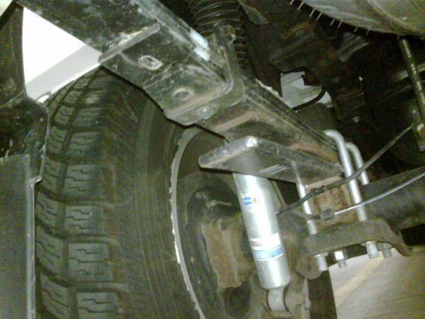

    This is the only shot I have of them installed:
