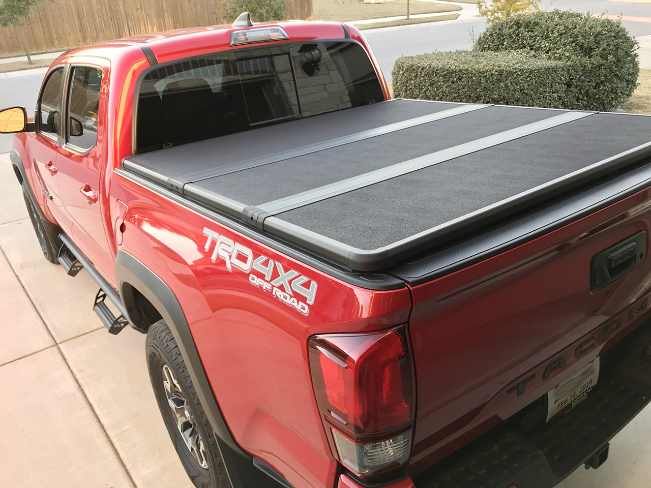

    After contemplating on which cover to buy (after trading in my 2018 Limited that came with the OEM tonneau), I took the plunge and bought the Extang Solid Fold 2.0 for my 2019 TRD Offroad. The sales guy on the website gave me a pretty good discount (paid $755 total) so that helped with the decision. Anyways, I got around to installing it over the weekend so I thought I'd share.
    The provided instructions were no help for Tacomas so I had to figure out how to mount the brackets on my own. The clips slide in to the existing cargo rails so I didn't have to remove those. However, I did have to remove the header rail to stick the included pads on each side, but that was easy. Even though the header rail was protected from leaks with the pads, I was concerned about the tailgate end. It looked like there were gaps where water could seep in. Overall, it was a snap to install.
    I've read that some people were concerned about the back end not being secured enough that a thief could lift it and see what was in the bed. Mine seems pretty secure that if I lift it with normal force, it would lift about a half inch. Now if someone used brute force I think they could definitely lift it higher to fit an arm through. This would give them an opportunity to unlatch the spring clamps and steal your stuff. I don't recall my OEM tonneau having this issue.
    We had some moderate rain over the night and this morning during my work commute. When I arrived to work I opened the tail gate to check the bed and can happily say that it was completely dry. I can't say if it'll stay dry through a heavy thunderstorm or a laser wash, but I think it should be fine. Just wanted to share in case anyone was on the fence about buying one.

    Thanks. Yes, there are clips at the front that you can snap to have the cover in the folded position so your bed is open. I meant to take pics of it, but forgot. If you look at the last pic, you can see them at the rear window.

    Here's a pic of me lifting it with a small amount of force. It may be more or less a half inch since the rubber strip folds.
