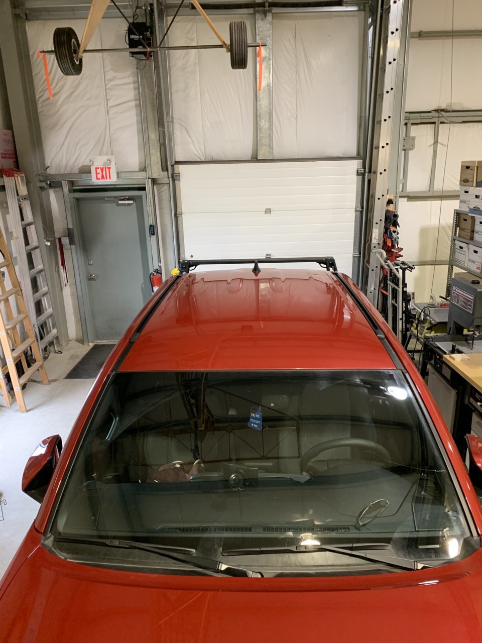

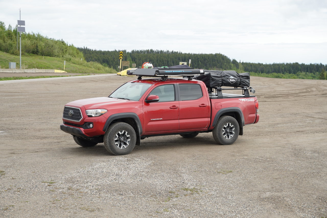

    Took the plunge and installed Rhino Rack RTS Track's (which mount in the roof ditch), a bed rack and stiffeners from TW Overland. I thought I would post this since I have not seen too many out there install the Rhino Rack tracks on the Tacoma's.
    RTS Track: http://www.rhinorack.ca/en-ca/produ...lt600-trackmount-black-2-bar-roof-rack_ja8957
    Here are the tracks installed with one bar installed (waiting on hardware for the second):

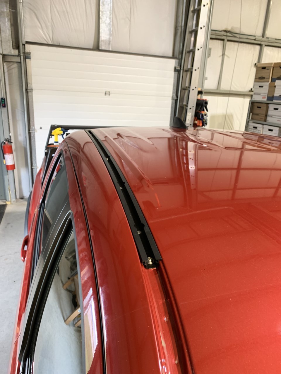

    Installation of the roof tracks was a terrifying prospect as it required me to drill 8 holes in my roof. I did a lot of research on the safest/smartest way to do this in order to avoid drilling into something I didn't want to, leaks and eventually having my roof rot away.
    After identifying the factory threaded mounts I needed to mount the track, I cut the seals directly over these points, and worked on fitting the tracks, which took a bit of effort due to the manufacturing tolerances on the location of the factory mount points. I ended up having to file two of the screw points on the tracks so that everything lined up. Once the tracks were where they needed to be and temporarily screwed down, I marked where I needed to drill my holes, removed the track and went about drilling. I used a drill stop to ensure that I did not drill past 3/16".

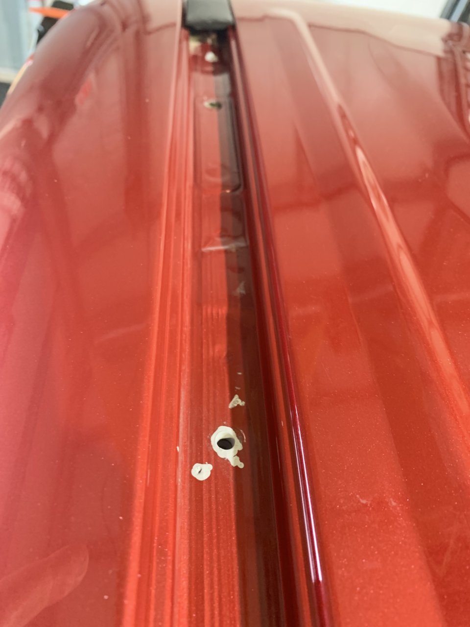

    I had to drill a bit deeper on a couple of the holes, but managed to drill through without causing any damage. Where I drilled did not appear to have anything between the hole and headliner which was somewhat of a surprise. In the end, I had 8 3/16" holes in the roof of my truck.
    Once the holes were drilled, I cleaned them up and applied a couple of coats of zinc rich/cold galvanizing paint to protect the metal.
    Once the paint was dry, I used a generous amount of marine grade silicone sealant in the factory threaded mount cavity's and Butyl patches on all of the holes to seal them up. There is also foam tape on the bottom of the tracks that I am sure help seal things. Once the track was screwed down, 8 pop rivets are used to help secure the tracks. The rivets add strength to the track and helped conform the track to the shape of the ditch.
    Once the track was secure, I cut the ditch trim to accommodate the tracks and installed the provided end caps.
    As terrifying as it was to install the tracks, it was fairly straight forward and I am very happy with the end result!

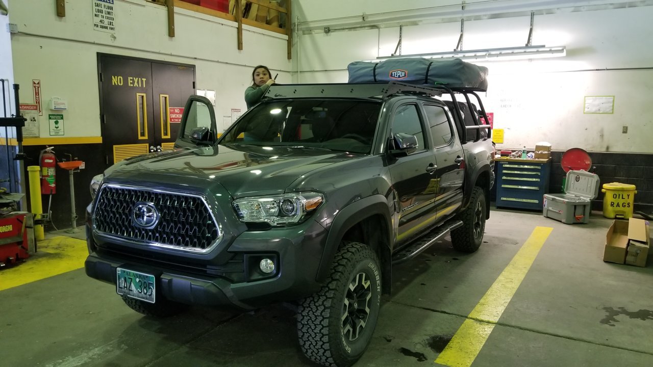

    I will be putting a pair of Rhino Rack's heavy duty cross bars on to mount an ARB awning, a Road Shower and eventually a couple of cases. Unfortunately, I was not shipped all of the right parts, so I was unable to put it all together.
    Very happy to report that after sitting outside in rain for 12+ hours, I have no leaks! I count that as a win.

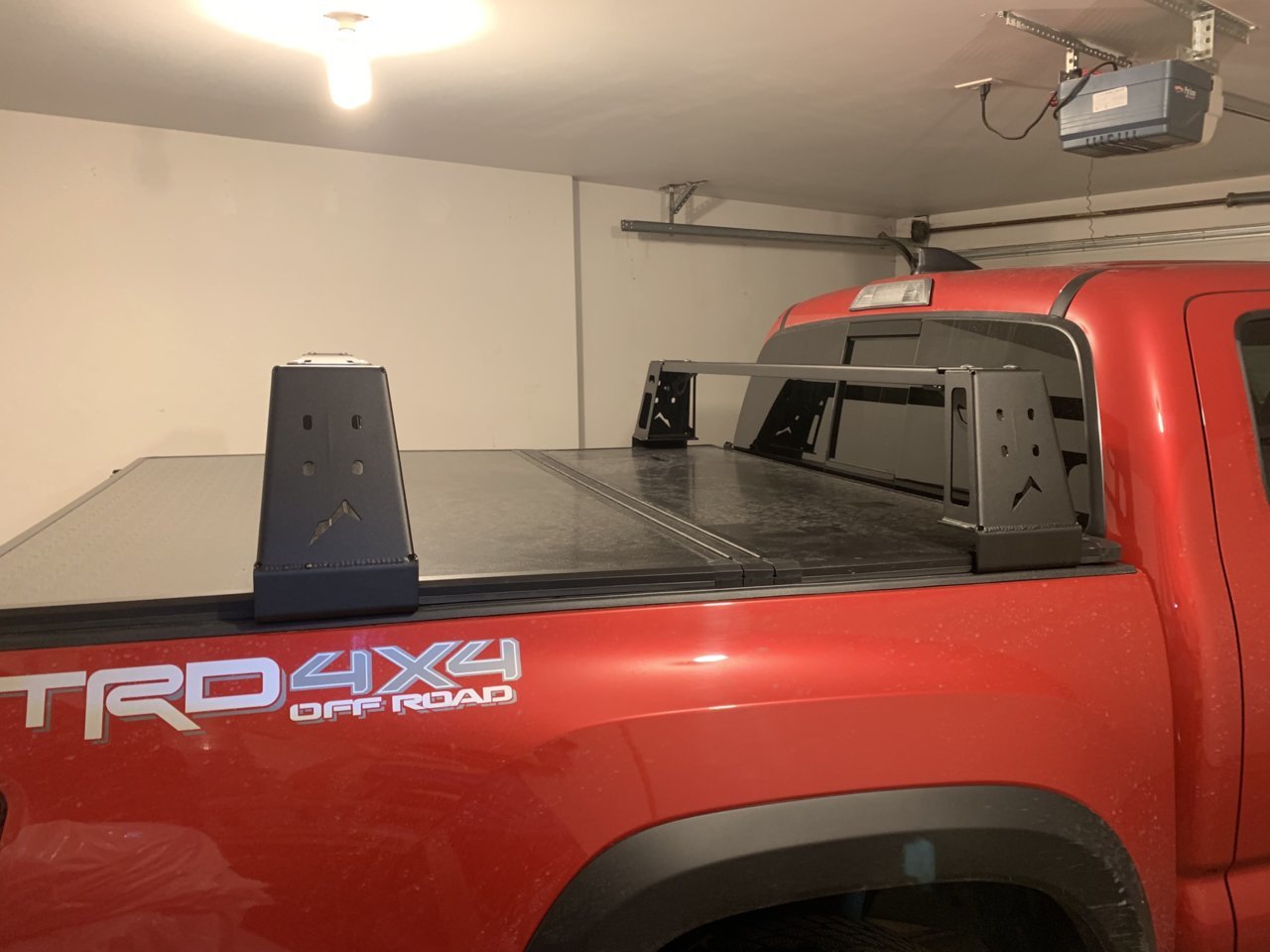

    The bed rack and bed stiffeners are from a local shop, TW Overland (https://twoverland.com/). I am pretty happy with the product and was happy to find something locally. Both products are powder coated steel.
    And finally, installed a pair of bed stiffeners from TW Overland. I am really happy with this stiffeners as they let me keep the factory bed d-rings and look pretty good in my opinion.

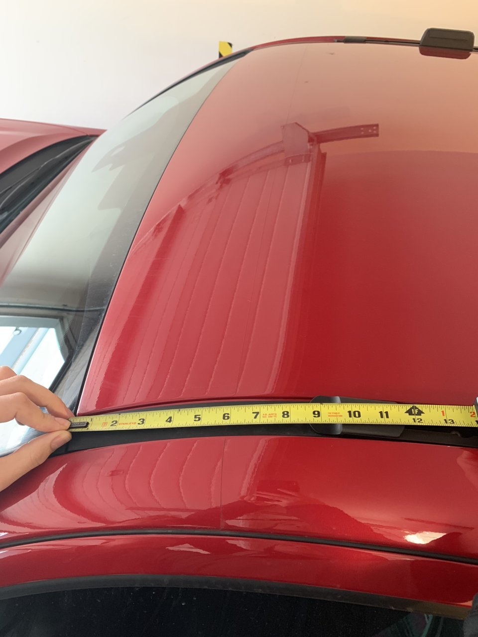

    I have been looking at these for some time. If you get a chance, could you measure from the front of the ditch strip near the windshield back to where the first bar can be located at it's most forward possible position?
  5. May 20, 2019 at 2:33 PM
    AltaTacoma
    AltaTacoma [OP] Well-Known Member
    Jun 20, 2018
    #256938
    69
    2018 BRM Tacoma TRD Off Road
    It’s about 11 5/8” to where you can mount the front tower. With the tolerances being what they are for the factory mount points, that could vary a small amount. The total usable length of the track is 43”.
    Hope that helps!

    Awesome! Thank you. I like having a good spread when carrying touring kayaks. Just want to compare it to my current Thule set. I like the track so much better than the wrap around door frame mounts of Thule and Yakima.

    No problem. You would be surprised how sturdy this setup is. I also don’t think it’s too difficult to use the Thule accessories on the bars.

    I am really happy with how the rack worked out. Took it for a 8400km trip to the Arctic Ocean, no leaks, rattles and the whole setup stayed solid. Mounted a Road Shower, ARB awning, and a borrowed roof basket. Its a bit noisy which makes sense as I went with the square bars and they sit a couple of inches above the roof, but when I don't need a roof rack, takes about 10 minutes to get the whole setup off.
    I play to eventually get the Pioneer Platform from Rhino Rack, just wasn't in the budget this year.

    I've got the same Rhino Rack tracks but haven't had the courage to install yet. How did you make sure the rivets won't leak through their centres???

    I recently bought the same tracks and will be installing them soon. The rivets that came with my tracks are a sealed blind rivet. It's a closed end on the mandrel side so the mandrel won't eventually fall through and create a hole like a traditional blind rivet. Google waterproof rivet.
