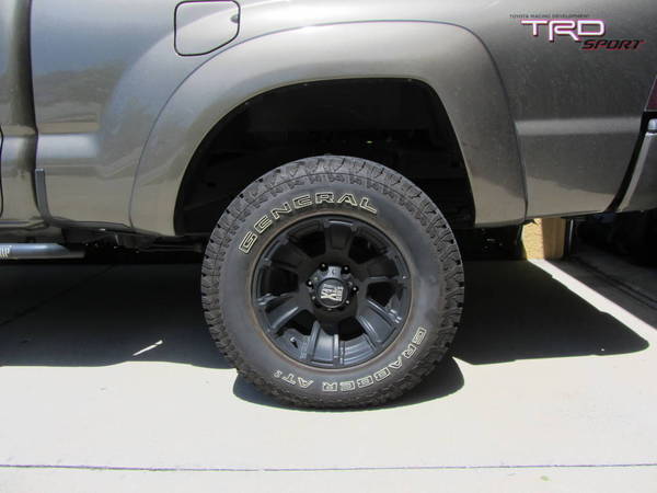

    Just wanted to follow up with a couple pics of the install and send a thanks to the OP and ajohnson for the help!! I did add a 2inch firestone spacer because of the add a leaf...so far the bags are holding air!:D Just curious how many pounds of air people are running around town with nothing in the bed?

    Nice pics! Good job on the install; welcome to the club! :)
