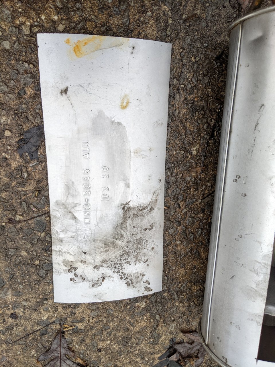

    Short and sweet. Replaced the rusty stock muffler with some tiny trashcan a welder sold me on. It droned so bad it had to go. Got this Bosal from Summit Racing, straight bolt-on. Two months or so in it started to rattle (not to mention leaked and the flange that affixed its pipe to the cat's bent before 20ft.lbs.)
    I now have a Walker SS Quietflow, and I cut up the Bosal to see what it's deal is.PXL_20211231_192924379.MP.jpg
    In this pic ^ you can see that the sectional dividers are crammed into place and only welded to the pipes. Unsure if that's standard for assembly, but it's the only thing I could identify as a potential noise maker.

    That's fascinating and disappointing. Thanks for cutting it open and exposing the guts. Bosal wont see a cent from me.

    i experienced the same thing, bought the bosal cause it was $10 cheaper and it was a whole assembly from the flange where as the walker was a 2 piece that had to be clamped or welded. after about 2 and a half to 3 months later it had a terrible drone and sounded like shit i tried to warranty but bosal customer service gave some extremely terrible customer service so i ordered the walker online welded it up and haven't had any issues for about a year now. Walker is definitely the best oe replacement.

    @luka4600 I wasn't sure if my experience was unique to me and appreciate the info! One of the big draws to the bosal for me was, as you mentioned, it's already piped and ready to go. Another was the method of bending. I figured the way walker kinks the pipe to bend it looked shoddy by comparison (just uneducated speculation,) but my opinion is revised. I'm super happy with it. The only negative mark I'd offer is that hangers and the tail pipe, to name a few spots, have some surface rust on them already. I may take it off and paint it later. Regardless, Walker is a breath of fresh air after my experiences.
