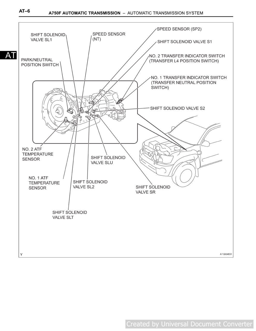

    Trying to replace Input speed shaft sensor (for speedometer, cruise control, ext). Engine light Code p0717. Location of this sensor please?

    That you be the Turbine Speed Sensor (NT), looks like it's on the left side of the transmission just behind the bell-housing.
    I haven't heard of one failing before, have you checked that the wires aren't broken?
