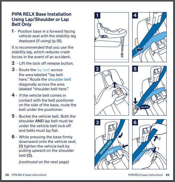

    I saw in the Tacoma owners manual that there are no lower mounting points in the center seat so I was going to try the seatbelt method listed on page 63.
    The Nuna RELX base owners manual shows a way to use the seatbelt to secure the base.

    Seat belt install will always be stronger/more secure in the event of a collision. Center seat installation is considered the safest as it's away from both doors in the event of a side-impact collision. Once your kid+car seat weight exceeds 65 lbs (at least in Canada), you would have to switch to seatbelt only install anyway. Anchor points are only good up to a specified weight rating (child + seat weight).

    That is new information to me. I have not looked into any documentation but assumed that the anchor points would be stronger. The center would be an ideal option for me if it does not interfere with the front seats. For my state they are required to use the rear facing seat until two and 40lbs. I will have to do some research but would prefer the safer option.

    Yes, from my research, seat belts were preferred over anchors. The seat belt method is super easy. Putting the infant seat in the center prevents both driver and passenger seat from sliding back to a comfortable position instead of just the front passenger. I’m 5’8 and wife is around 5’5. My wife usually sat behind me instead of in the front passenger seat, even now (our son is almost 2).
