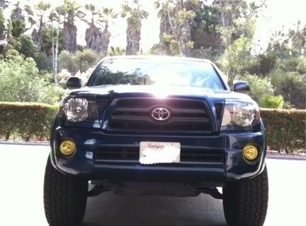

    That's not true, because i have personally purchased it and and painted my grille with it (pic below for proof :) )...I think the paint code is 8P4...I still have a can at home, i'll confirm that is the right paint code when i get home tonight.

    My grille was originally chrome. I sanded it down to rough it up, then wet sanded lightly to make sure there where not sanding grooves.
    Hit it with 2 coats of rattle can primer, then with the dupli-color paint (as stated above, it is not called Indigo Ink, but the code is 8P4 and it is the right color). I did enough coast till it was completely and evenly covered, then used a rattle can clear coat.
    You will get different opinions on how to lay the clear coat, but i lay it on thick (but be careful or it will run). The clear coat is what will make it shine like the rest of the truck, so laying it on thick gives the best results, IMHO.
    I did a couple thick coats, then let it dry real good before putting it back on.
    The paint matches just about perfect, and I would definitely recommend it!

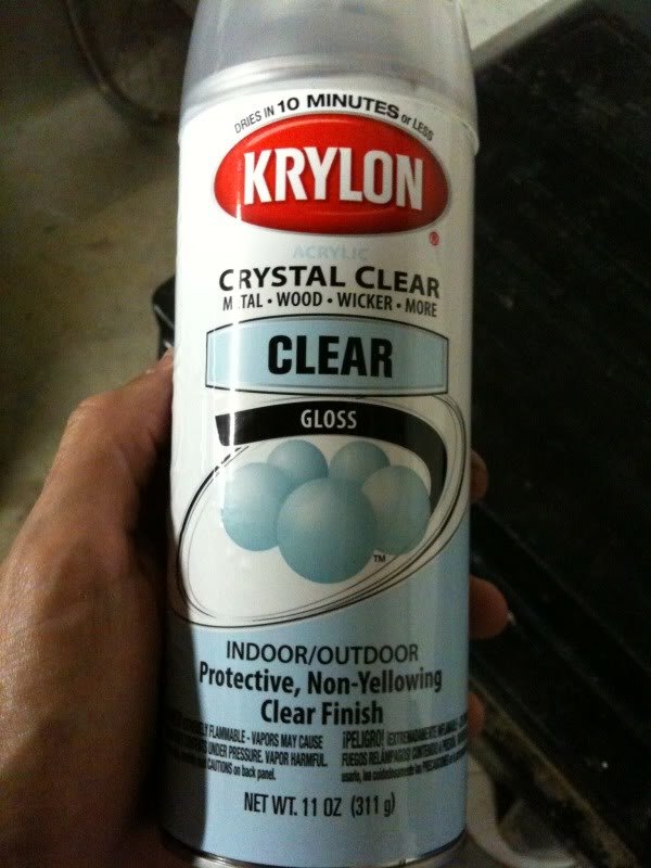

    Sorry for the delay. Here is a pic of the paint can and the clear coat can i used.
    The paint name and code is: Dark Blue Pearl (8P4) - There is a sticker on the cap that has the name and code on it. I tried to snap a pic of it, but didn't realize it was too blurry to read until i went to upload it...

    pic of the grill in the sun and up close man???? how was the clear going on????
