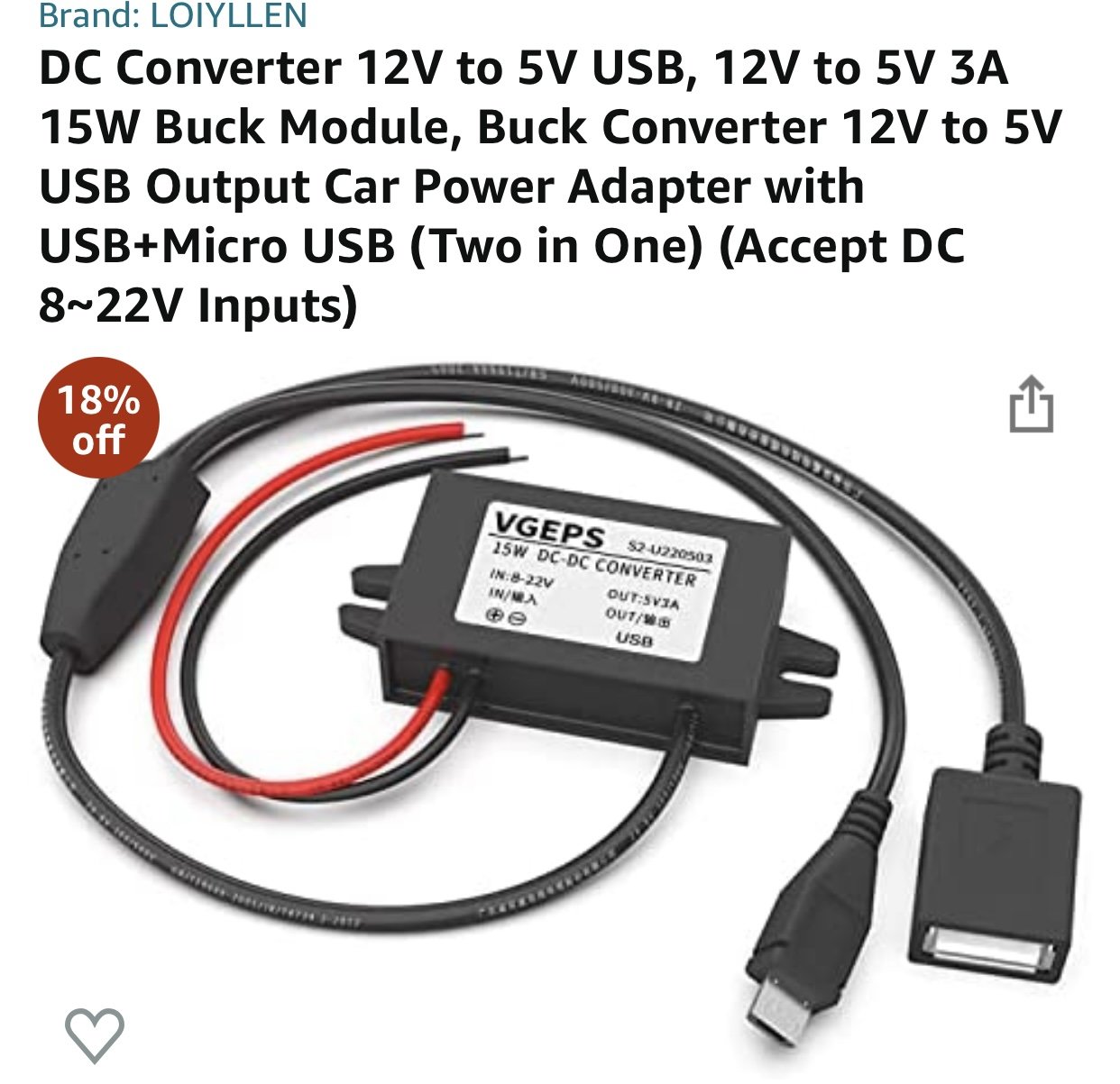

    interesting. So it’a out of stock and will look for an alternative, but meanwhile I ordered these:
    67FAA4C8-7022-44EC-9315-E873989244D1.jpg FF8CEEA3-B989-4BDA-A016-FC748D5DC11A.jpg
    Will look for an ACC on 12V output behind the headunit to connect the positive to, then have the Y splitter connect to the factory location USB port for a clean look. Fingers crossed it works and doesn’t damage the HU.
