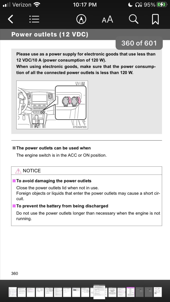

    Does anything else power up from the outlet? Perhaps the fuse blew.
    If I recall there is a sticker on the outlet’s cover which states the maximum current the outlet provides.

    This is from the 2014 owners manual.

    No fuse blown. I plug my phone charger into both outlets and it works. Yeah the sticker says 120W max.

    In that case the power station should charge then as it’s charging at 8A according to ecoflow, right? 12v x 8A = 96W

    Correct 12v at 8a is 96 watts which is below the 120w maximum. Something else is keeping the fridge from working.
