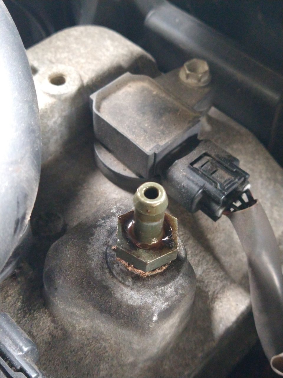

  9. Apr 19, 2021 at 2:02 PM
    Janko630
    Janko630 Active Member
    Mar 4, 2015
    #150087
    33
    Jan
    Florida
    2003 2.7L 4X4
    Oily PCV no bueno.
    2003 2.7l 4x4
    98k miles
    Black97v6MT likes this.
  10. Apr 19, 2021 at 2:29 PM

    What would this imply? Happened to me a while back before I replaced mine.

  13. Apr 19, 2021 at 4:07 PM
    Janko630
    Mar 4, 2015
    #150087
    33
    Jan
    Florida
    2003 2.7L 4X4
    It implies crankcase ventilation is compromised. OEM replacement valve was $10 shipped from Daytona Toyota via eBay.
