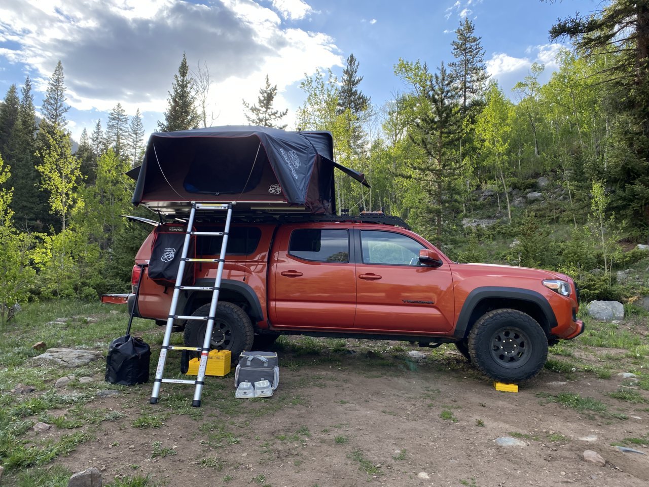

    Here’s one from last weekend.

    This is a very nice setup. This is the full-size Skycamp correct, not the mini? I was looking for a setup that supports the full-size Skycamp on my 2017 Double-cab shortbed, it looks like to get the full-size Skycamp I will indeed need a camper shell or some setup that supports a full-length rack, level with the cab. I had doubts that any camper shell would support a tent set up on top, but I guess it is possible.

    It is the full size (4x). I have a SnugTop Rebel with the sportsman package the increases the roof weight capacity. I’ve seen folks without the added package still use the regular Rebel with a RTT.
    You’re right, you’ll need something cab high for the full size Skycamp, or it will hang off the back roughly 8-10”. I used to have the AluMax from MaxModular. That bedrack was great and light.

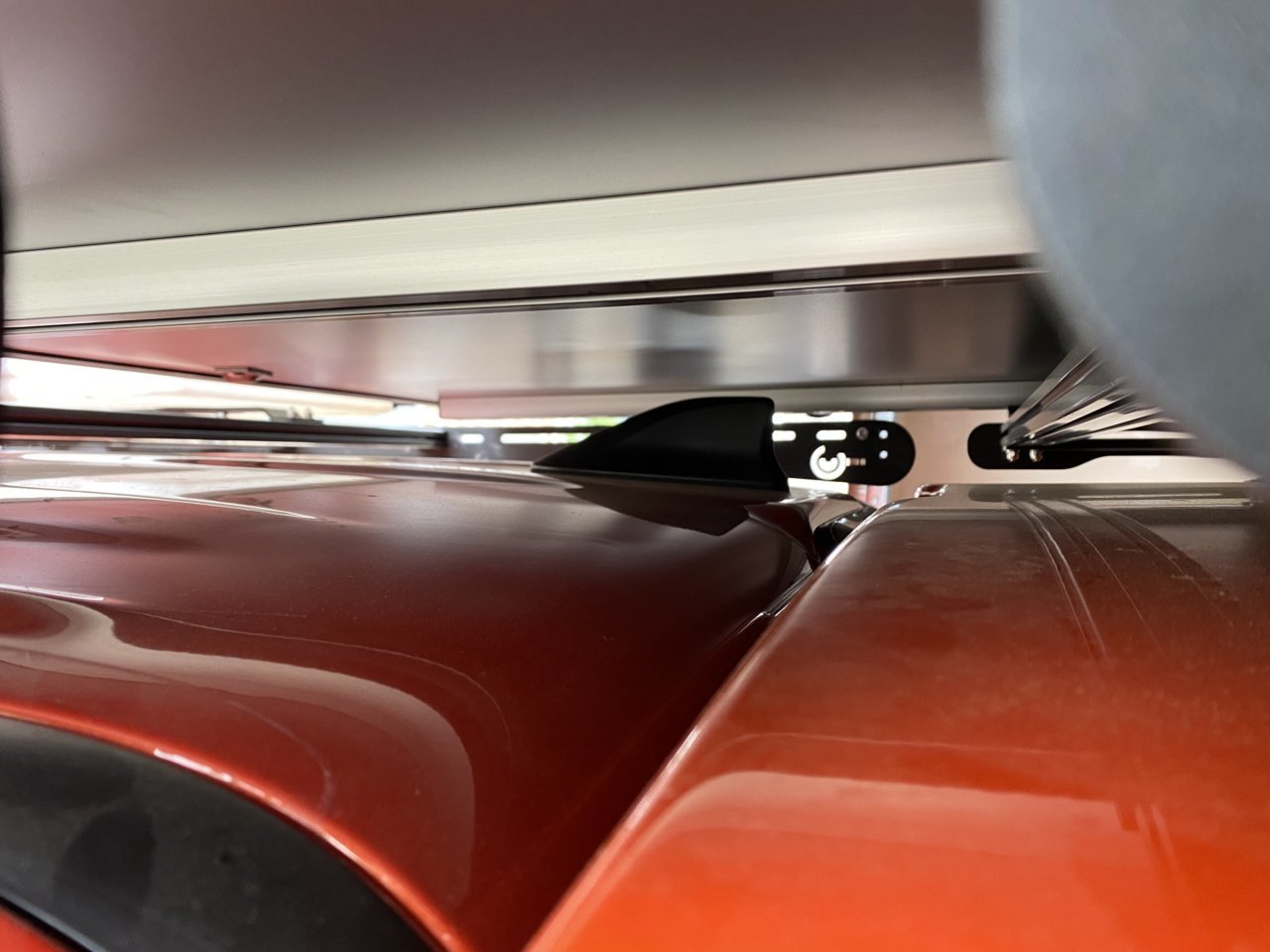

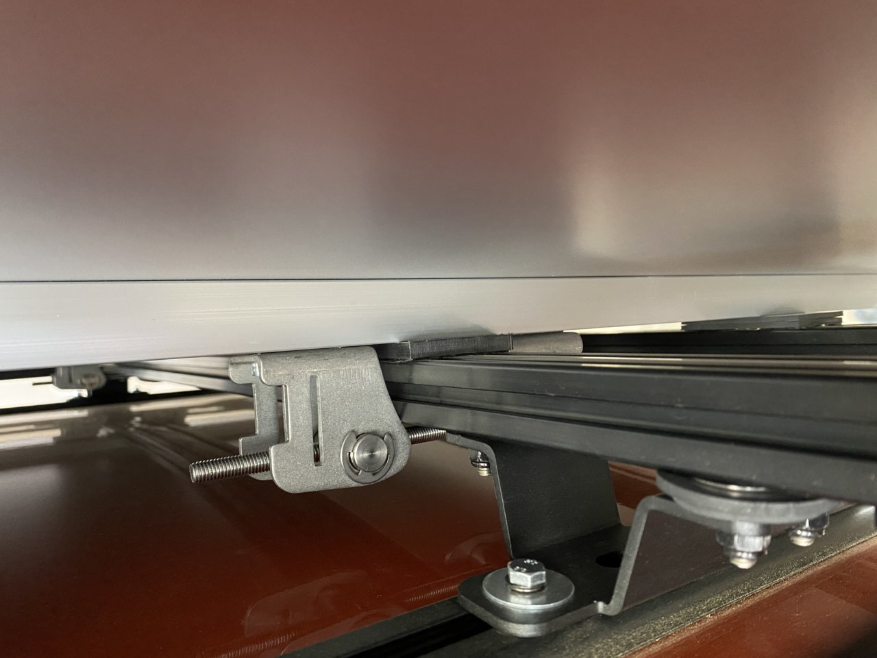

    One more follow-up question :) With this setup, we need to mount the tent across two racks. When offroading I would expect there to be some flexibility between the bed and the cab, I could be wrong here. But if that's true I'm curious if mounting the tent across two racks like this is susceptible to mounting failure? Failure of the tent to the rack, or even worse, mounting failures between the racks and the bed or cab. Have you encountered any issues like this?

    It’s ironic you ask about this. I’ve been trying to figure out the best approach to this exact issue.
    I tried multiple approaches:
    - attached to just the toprack and laying on the cab rack
    - same as above with plastic spacers on the two bars where the tent mounts are attached
    - same as above with anti-vibration pad under the 5 other crossbars on the toprack
    This worked well but the tent would still bounce on the back two crossbars of the cab rack. After talking to a handful of folks across TW, Facebook, and in person, I decided to remove the back two bars from he cab rack and keep the spacers and pads. The tent requires a minimum of 29” center spacing for safely mounting. This setup achieves that and avoids the metal on metal wear. I don’t have any photos. I can throw some up if you’d like.

    Great feedback. This is very helpful as I'm thinking through various approaches. I'm starting to think a mini on the camper shell might be a good starter, then incrementally add on from there. I've seen pictures of a mini on the cab and another on the camper, this sounds costly but I guess it is an option. So much to think about :)
    Yeah if and when you have time I wouldn't mind seeing some pics, no big rush. Thanks again!

    Here you go

    Did you have to pull the bars to mount them drop on and bolt the crossbar? Looking at putting a mini over my cab and the sides are wider then on the toprack ?

    I can’t speak for mounting on the TopRack. But for mine, I just set the tent on the bars, centered it, and tightened the mounts. The Prinsu racks aren’t the easiest to work with given their low profile.

    Thanks I might try the 1.0 hardware, not much room so ill probably end up pulling the bars then mounting and drop back in place.
