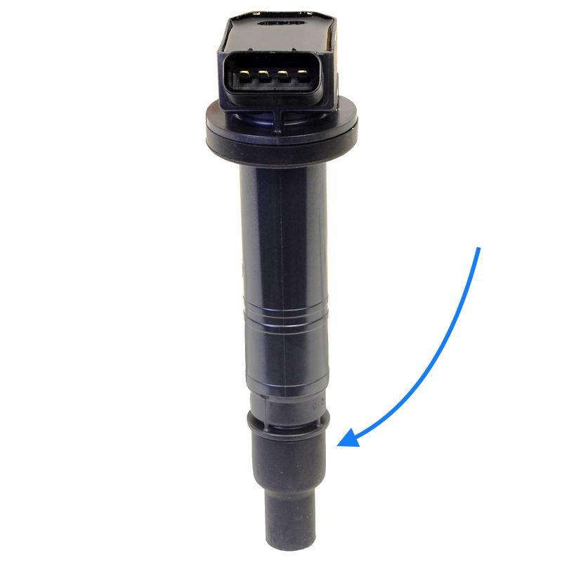

    Installed new iridium plugs when I redid the valve cover gasket ~15,000 miles. I used the plugs listed in the manual. Don't have it next to me right now off hand. Coils are dry, no oil. Failure cylinder appears to be random and with multiple brands. DENSO 673-1308 are the coils I see listed on Rockauto. I haven't had time to contact a dealership to see what was oem ( I work some crazy hours during the week right now). What are the "boots" for a coil on plug setup. I'm used to vintage vehicles where there is an actual boot and wires.

    The boot is the rubber piece on the bottom of the coil that snaps over the plug.
    Denso doesn’t sell the boot separately.

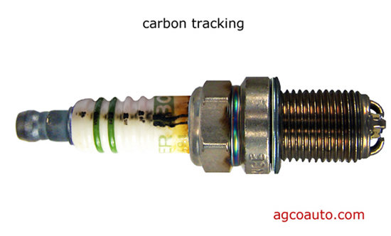

    About the only time I replace them (if applicable) is when the old ones are oil soaked or when the plugs show signs of carbon tracking.
    Boot
    Carbon Tracking
    Jimmyh, Taco 422, b_r_o and 1 other person like this.

    They're available.. I used a set on 2.7 today that got a valve cover gasket
    https://www.partsgeek.com/2mmptpj-toyota-tacoma-direct-ignition-coil-boot-kit.html
