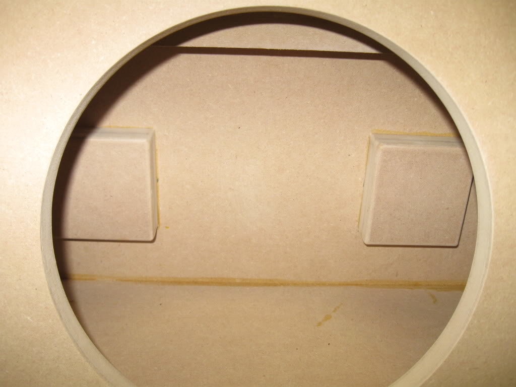

    "Mr. Marv" has some cool designs where he worked around the bolt brackets.
    Example: gliderandenclosures007_77588b648085542a7bd5e301d3f0bc8dc3cf4968.jpg
    Search the forum and you'll see his contact info. He's very generous with his advice if you're going to do it yourself and does fantastic work if you have him build it.
    btw, I run a single box he built with an IDQ10v3. I listen to rock, not rap and it sounds great. Maybe you'll want a little more for rap. 2 IDQ10s will be extremely strong.
