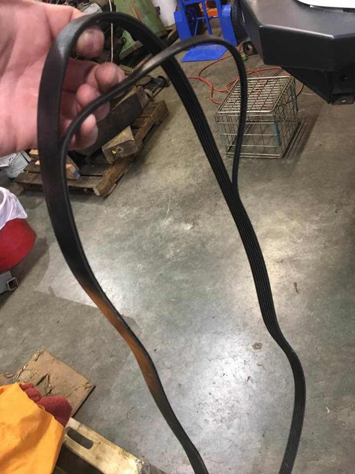

    FYI if you do change your whole tensioner, buy an OEM replacement at a dealership, ones you find at autozone or oriely's etc are not an exact match, you will see once installed that the belt does not sit center on the pulley. See pic above of belt... thats what happens when you use them. Learned that the hard way.
