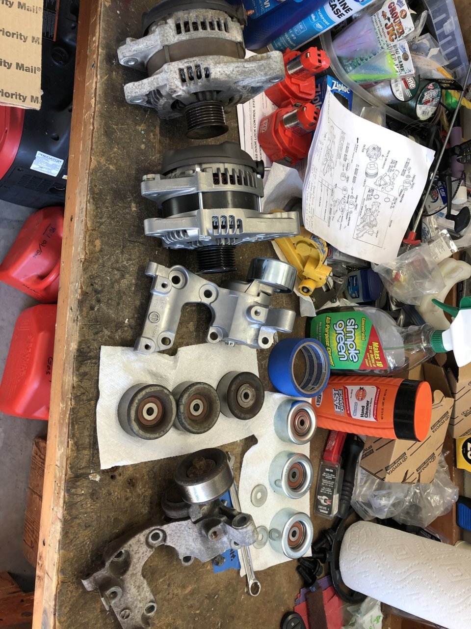

    Todays fun on the 2009 with 155k was the 3 idler pulleys, the tensioner, serpentine belt, and the alternator. Idlers and alternator all pretty easy and straight forward.

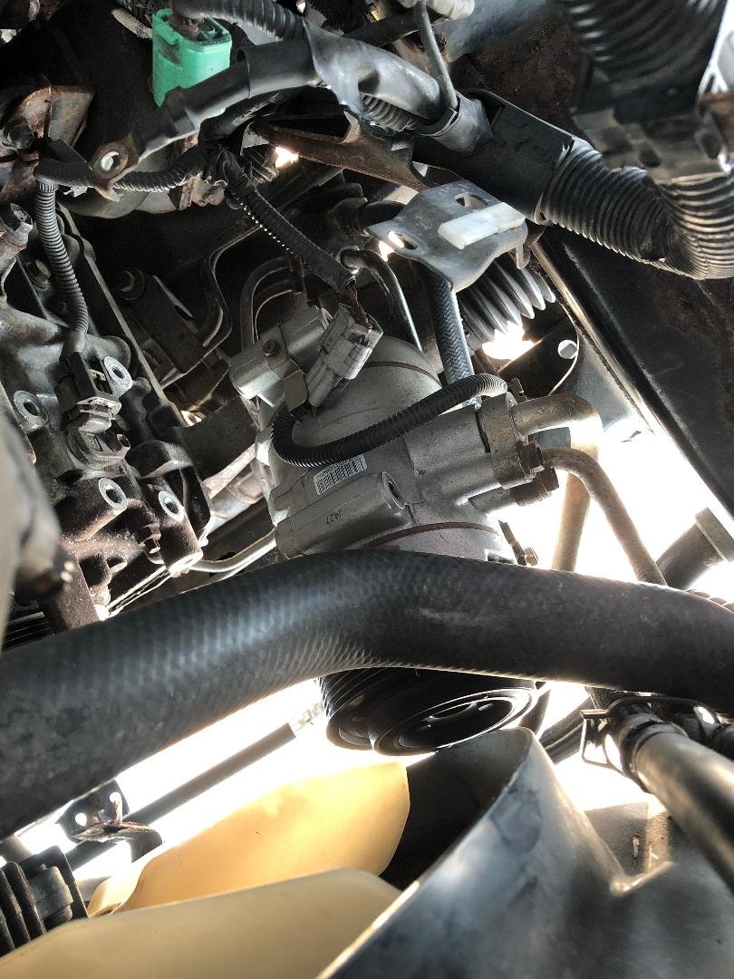

    The whole tensioner assembly is underneath the alternator (OK changing same time) but then the AC compressor is also bolted on top of the assembly. I attached a video link that's helps for those that need a tensioner etc. The 4 AC bolts are hard to access getting off so watch the video but he uses a garage rack and I use jack stands and the floor so never as easy. Its for an FJ but same 4.0
    https://www.youtube.com/watch?v=UhG9owRQFy0

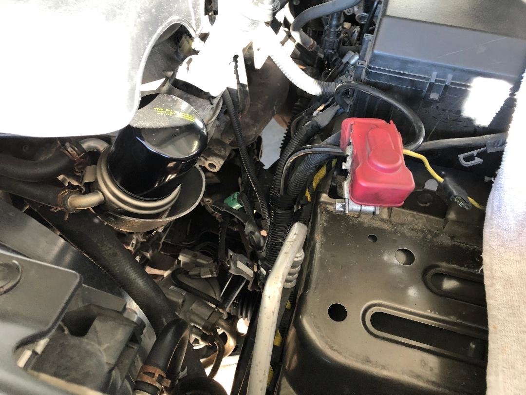

    To get the alternator out remove the battery , tray, and unbolt the wire retainer between battery and engine - you will see it. Then you can move the wire bundles out so alternator can be pulled up and out.

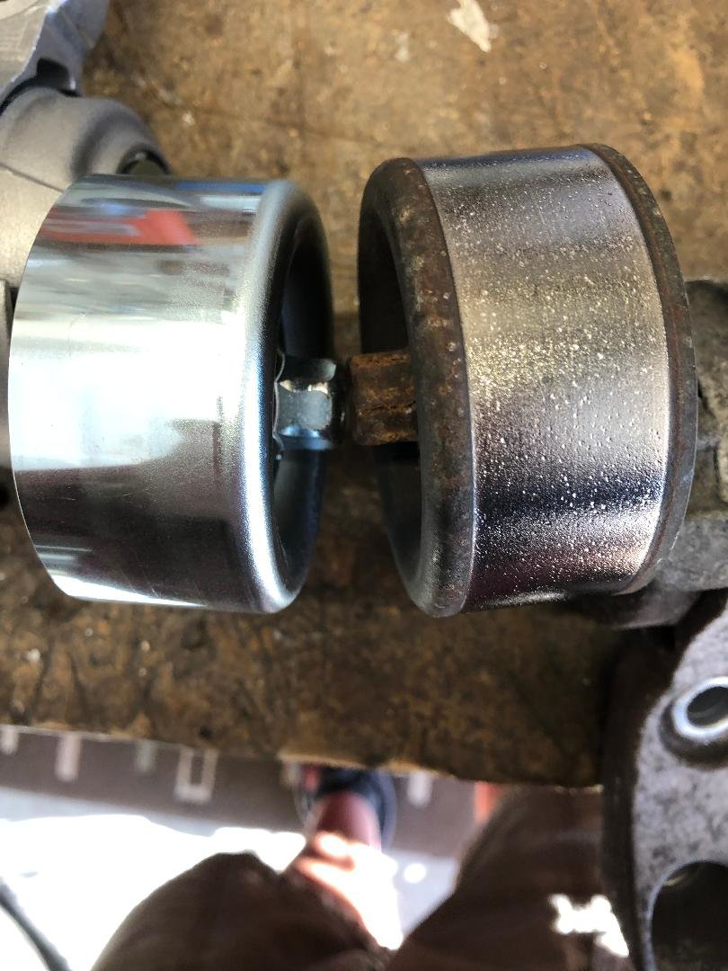

    Bottom line is the tensioner was getting pretty loose and slight grinding when spun. All the pulleys were worn with a slight groove and all appeared to have belt slip at some time. I changed as during hard downshifts to accelerate I could smell the belt.
    New belt was needed and even got the wife to hold it on the PS as they are hard to get on alone and oh no she got a dirty hand, not compared to me all day.

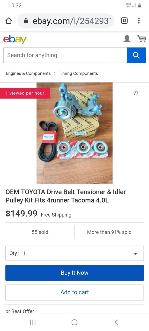

    Screenshot_20200206-103202_Chrome.jpg So yes or no on this? Dam this truck is just constantly needs to break down on me! Thanks for any help guys

    My OEM pulleys all came in boxes not plastic shrink cards and all 5 items cost about $300 with discount online so that pack is 1/2 the cost so doubt OEM.
