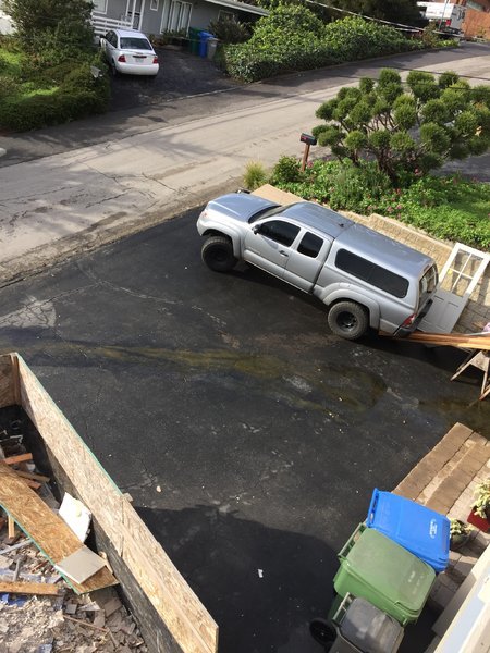

    Might as well take a break from work and chime in. About 11 months on truck With overload. Height is almost 39" to fender or 23.5" from hub. I think. Worst angle for this but all I've got at the moment. Stock 4 leaf was pretty flat but these really brought some life back to it. Thinking of getting alcan #5 or 600lb pack in the future (toolbox, tools, shell) but definitely recommend these. Leave overload if you carry weight otherwise ditch itIMG_2620.jpg
