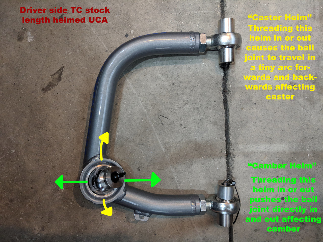

    The icon UCA adjustment is at the threaded mounting heim.
    To adjust them you have to remove the long UCA bolt and then thread them in or out. The one in the back adjusts camber while the one in the front adjusts caster.
    This is in addition to the cams on the LCA that also adjust Caster and camber.
    The typical procedure with aftermarket UCA is to set the caster cam on the LCA to maximum forward giving the most clearance for the tire from the body mount. Then use the UCA to correct camber that can’t be corrected with the LCA camber cam bolt.
    Your mechanic will need to remove, adjust, reinstall, and repeat with the icon UCA. The genius of the SPC UCA is that the caster and camber adjustment can ba done with the UCA installed because the adjustment is made at the upper ball joint mounting design. The ball joint can be rotated forward and backwards to adjust caster and slide in and out to adjust camber, all while remaining bolted in place.

    I thought that the Icon while being Heim was actually adjusted on the vehicle?

    How do you adjust the hiem with the UCA bolt going through the hiem eye?

    Looks like the Icon heim joints don't thread into the UCA directly; there's a sleeve. The sleeve is reverse-threaded on the outside, it would act like a turnbuckle.
    That said, the heim joints will likely need monthly spraying with teflon lube to reduce noise.

    I was unaware, and stand corrected. In that case it seems adjustment of the icons while installed wouldn’t be too difficult. I don’t know the max forward caster the Icons can give compared to the SPC. I also don’t know the longevity and maintenance of the delta joint vs the SPC ball joint, or how the ride is with the hiem joint vs bushings. All things to consider.
