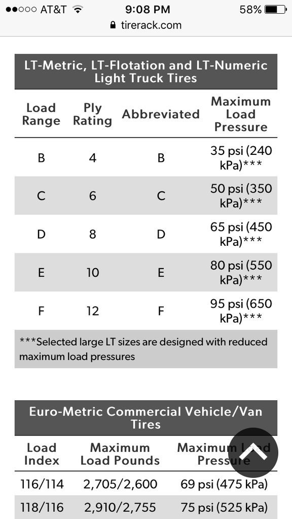

    From tirerack.com website

    F?! I feel inferior.
