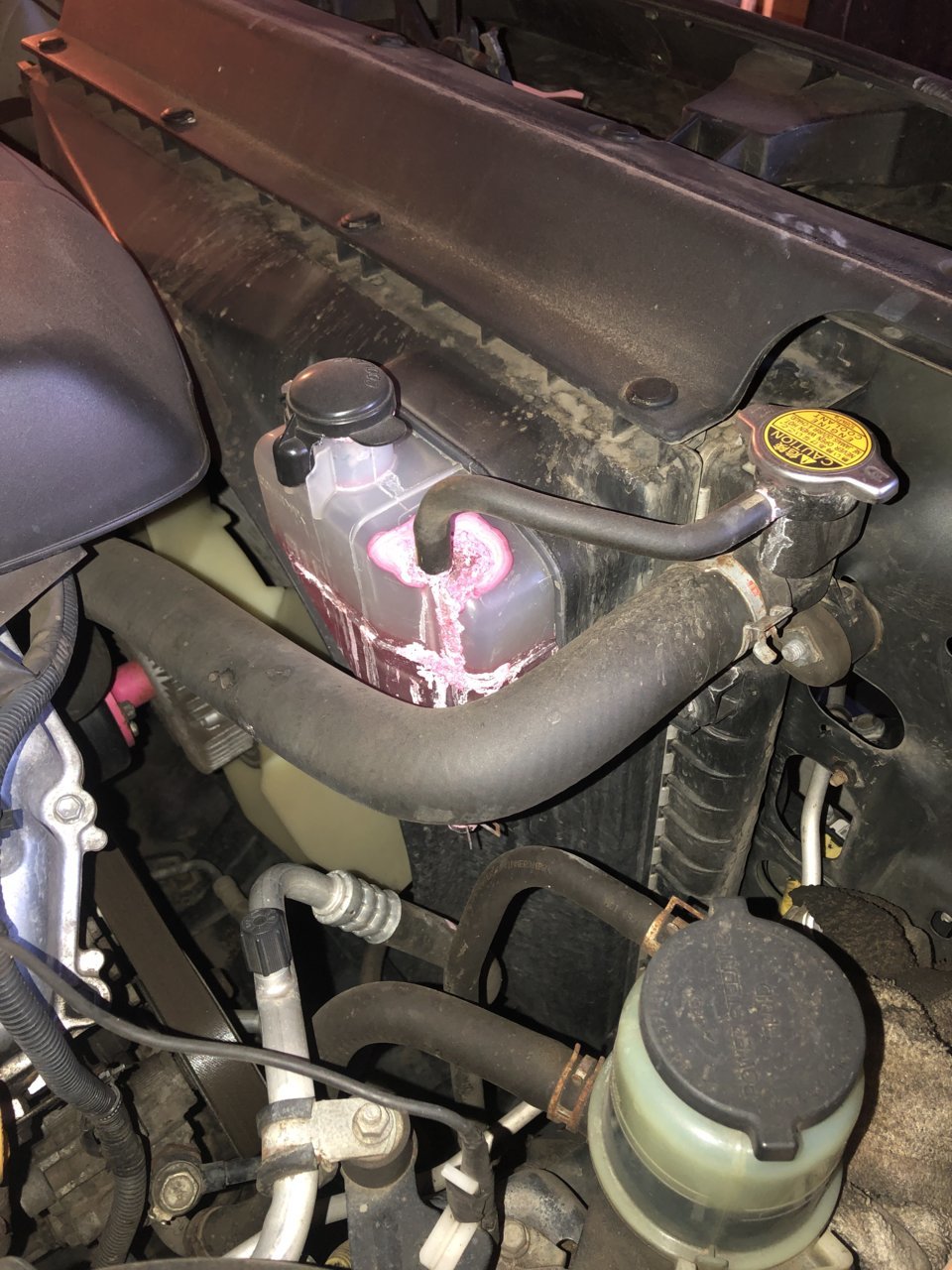

    Hello. I was hoping someone can tell me what’s going on.
    I don’t noticing my truck running hot.
    I have an 09 with about 147k miles.
    I’ve never had a tranny flush.
    The water pump was replaced about 2 years ago.
    I had seen small amounts of this in the past but nothing like this.
    Thanks for the help.

    I've never seen the pink milkshake, but I've seen chocolate milk- green coolant and oil. That was from a cracked head on a work van. Hope that's not the case here.

    That is just the coolant overflow. It does look a little high. How is the level in the radiator? Is you cap working properly? It just might be that the hose needs replaced.

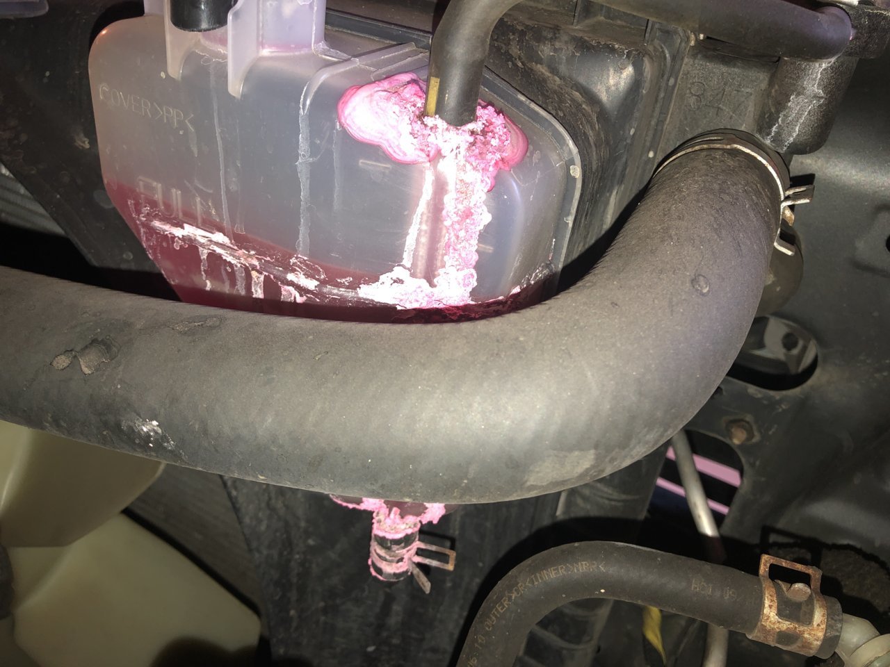

    Hose is split. Engine gets warm, builds pressure, excess coolant flows to bottle, gets to split in hose and runs down outside of bottle. Do it enough and it builds up

    Try cleaning it first to see if it comes back. Rubber piece gets worn out and have coolant seeping out. When cold, take off radiator cap to see if there’s any sediments or oil trace.

    Just looks like you need a new hose, the one attached to the reservoir where the coolant is leaking out of. Doesn't look like a milkshake to me, the coolant in the reservoir looks normal and the stuff on the outside just looks crusty from drying up

    Hard to say from those photos, just looks like overflowed as noted above. How does the ATF fluid look?
    This is pink milkshake.

    Appreciate the info guys. You have given me a few things check out and take care of. I’ll replace the cap and the hose.

    Looks like a little coolant leaking from somewhere, shouldn't be a big issue.

    Its this.
    "Pink milkshake" plagued 1st gen tacos / 3rd gen 4 runners wherein transmission fluid and coolant mixed within the rad.
    What you are seeing is just due to likely a crack in the coolant overflow tank or a split hose.

    Crusty coolant leak,its NOT pink milkshake.

    Def a loose hose. There's also no clamp on the hose and there should be.
