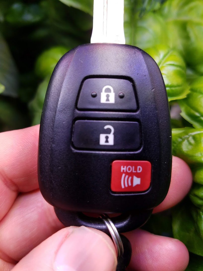

    Last week I had several times where my panic alarm went off. The last straw was when it went off at a rather inconvenient time and place. The button ends up getting pushed while it is in my pocket. I can't think of any reason where I would use the panic alarm. If I need a panic alarm I have some on my belt that have talons and weigh 230 grains each. So last night I disabled my key fob panic button.
    What I tried first was to place a curved wire around the internal switch button. This increased the amount of pressure needed to get the alarm to go off. It is also reversible. However the panic button still worked. So I just went ahead and clipped off the nub off the back of the panic button. I left the curved wire around the internal button. Now even with a hard press the panic alarm does not go off.
    I should have done this starting years ago to every key fob I have ever had.
