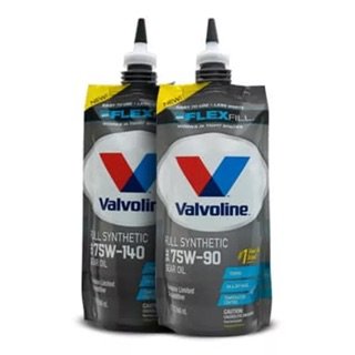

    Counterpoint:
    I don't know who was first on the market with sqishy bags but they are very convenient. Got a box of four for less than fifty bucks on Anazon.

    Whoever invented those durable squeeze bags for gear oils deserves a Man Medal!
    I save them, and use for filling the transmission when spill-and-filling. Just use a little transmission fluid to clean the bag out first. Spread the bottom of the bag out, add a funnel to the top, and fill with fluid, replace nozzle. Add the little cap to the nozzle to prevent spills, slide back under the truck, remove cap, insert in fill hole, hold flush to prevent spillage. You can then squeeze it all out through the transmission fill hole in just a few seconds!
    It is faster and less messy than fooling with a pump to get the fluid in there, and you don't waste as much fluid.

    You can also attach clear tubing, 5/8th ID, I believe, to help drain every drop. Used the tubing on the hard bottles also but squishy bags are still the way to go.

    Going to be doing diff oil service on my 2009 soon and I'm happy you posted this. Those squishy bags look bomb. Pumping the gear oil out of the tall bottles is my least favorite thing. My arm is on fire after the 2nd quart haha.

    coming from a guy who blew up a ford 9in as a teenager, and had to figure a way out to pour from a jug the bags are the best
