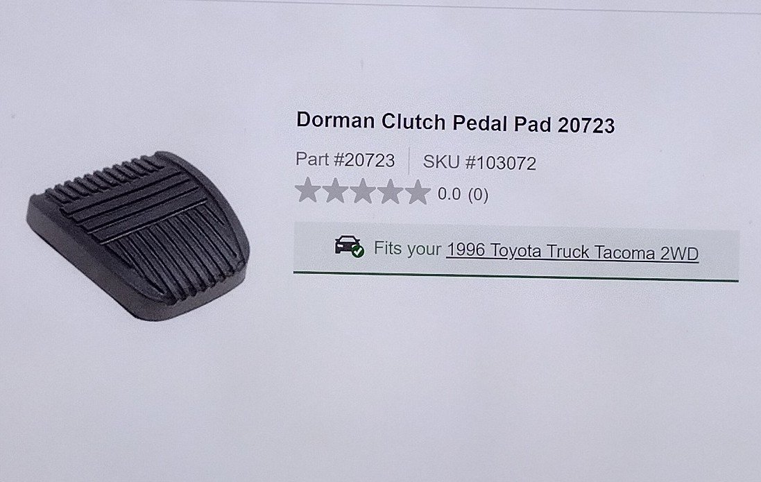

    I've never dealt with relacing a clutch pedal pad before (the left side of mine is worn to the metal).
    Are these glued on or screwed on?
    Any tips for taking the old one off and the new one on?
    Appreciate your comments.

    They just slide on and off. Depending on your hand strength I just pop them on and off.
    Having the new one nice and warm works better then it being a frozen block of rubber.
    I am pretty sure most Toyota clutch pedals are the same size.

    Pops off and pops on. 2 minute job.
