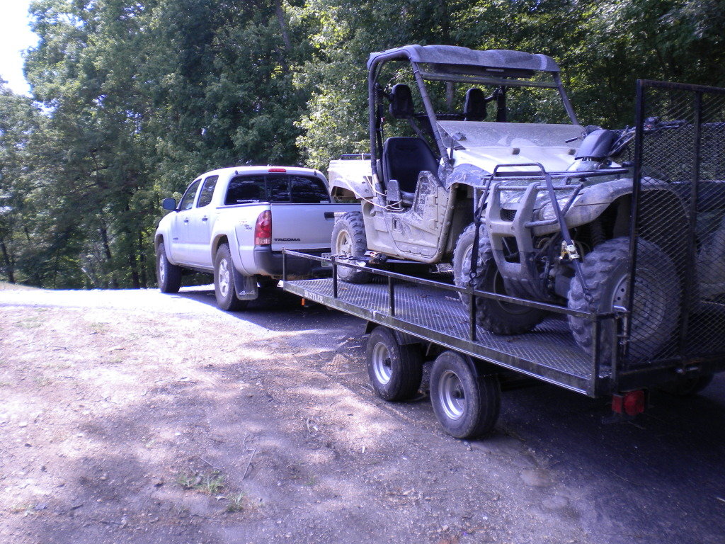

    i see you have a v6. you will be just fine. i have a ’07 DCSB trd off road 4x4 with auto trans and tow pakage. i tow about 3k maybe a little quite often when going 4 wheeling. i keep it in 4th so the over drive does not kick in on hills. I don’t see any reason for you to need to go to a auto with that light of a load. you will under 1/2 the rated towing capacity.
    (hold on i’ll post pic of what i tow.)
    edit: pic. trailer is a 7’x12’ also does not have trailer brakes. and by it self is prob little over 1k DSCN2818_ff01332814ad652817e8839008b337e3f3b2a17a.jpg
