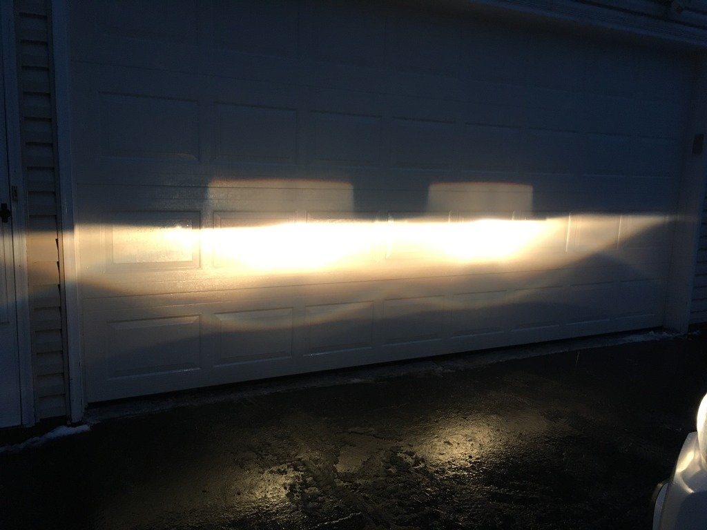

    I have the TRS/Morimoto 50W HID kit with 6500k bulbs. The 6500k bulbs look more like 5000k when run with a 50W ballast. I like them a lot. No shake/bounce after having them over a year and 30,000 miles.
    Here are my results linked from the Morimoto Elite thread:
