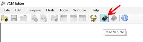

    Open the VCM Editor, connect the MPVI2 as outlined above. Turn the ignition key to the "ON" position and click the "Read Vehicle" button shown below:

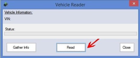

    You will get a pop up like the one below. You'll want to click the "Read" button, and allow the software to connect to the truck and the HPTuners servers.

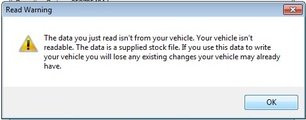

    You will get the following pop up indicating the virtual read is complete. Click "OK". This message is 100% normal and is (IMHO) a confusing way of telling the end user the virtual read has been performed successfully.
    *Virtual Read* Some ECU's cannot be directly read from the OBD2 port as the manufacturer because never intended to read the content of the ECU, only flash it for updates. So, the virtual read is the only way to read the ECU data. Our ECU happens to be one of these. When you attempt to read the stock tune file from the truck, The MPVI2 will read the stored VIN number and Calibration ID number and report these details to the HPTuners servers where a copy of the tune that was original to your ECU will be supplied and you'll see the pop up message indicating the virtual read was performed. With this virtual read, even if the car is tuned, if you read the car, you will always have an original file.

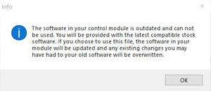

    Additionally, you may also see another pop up message about your ECU being outdated as seen below. This message is displayed when the Calibration ID of your ECU is "outdated" and there is a Toyota TSB updated calibration available. You will be supplied the latest variant of your Calibration ID at the time of the virtual read. *This can have implications if you are currently without a supercharger but plan to later fit the TRD/Magnusson Supercharger. More on this to come*
    Once the above messages are acknowledged, you'll be prompted to save a file. This is the stock calibration (virtually read) and supplied to you in the previously mentioned .HPT format. Name this file as you please and save it to a location you can remember and/or easily navigate too. The .HPT format is a proprietary format that contains all of the OE calibration data but additional details specific to HPTuners.

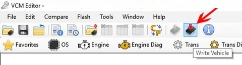

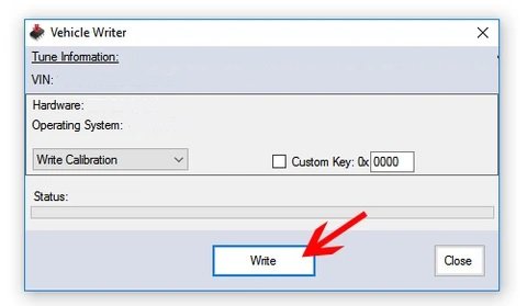

    With the above precautions taken (and any others) you'll want to ensure you have the file you wish to flash open in the VCM Editor, an internet connection and the MPVI2 is connected to the OBD2 port and to the laptop. Click on the "Write Vehicle" icon shown below:
    You'll get a similar pop up to the one below. Click on the "Write" button and depending on the licensing you'll either be prompted to license, or the flash will initiate. If this is your first time reflashing the vehicle you'll need to license, which we'll cover in the next section. Write times vary depending on the ECU hardware. Flash times for the earlier ECU's take between 3-4 Minutes where the newer ECU's take 1-2 minutes. DO NOT INTERRUPT or UTILIZE OTHER SOFTWARE DURING THE FLASH PROCESS!

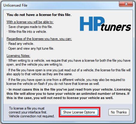

    Licensing
    If this is your first time loading a tune file back to the ECU, you'll be prompted and informed you do not have a license for this file. The image below (outdated) is what you'll be prompted with. You'll want to select the option to "Show License Options" and on the following screen select the VIN Specific option. Continue to follow the prompts. Keep in mind that once you use your credits, they cannot be refunded. Upon licensing, you'll be prompted again with option to "Write" calibration. Follow the above instructions to flash the tune file.

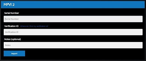

    1) Registering Your Device
    If you didn't purchase your MPVI2 with the credits pre-installed, or you're needing to add more credits to your device, you're going to need an account with HPTuners and register your device with them. You can do that here: HPTuners My Account

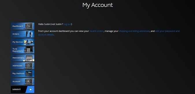

    Once you've either logged in/created an account, you should see this:
    Once here, click on the "My Devices" icon of the left. That'll bring you to a page where you can enter the details of your device. Be sure to pay attention to the headings, as there is a spot for the registration of an older MPVI device. So confirm that you are inputting your data in the MPVI2 specific data entry fields. It should be the form below.
    You can find the serial number to your MPVI2 on the device. Input that data in the appropriate field and for the "Verification ID", open up your VCM Editor (leaving the registration page open the background). Navigate to the "Help" menu and select "MPIV2 Verification Code".
    Save this code and back to the HPTuners device registration page and input your "MPVI2 Verification Code" in the appropriate field. Input any Notes you may want about this device. Once all fields are complete, click the blue "Import" button. This should save your device to your account and you should see it listed at the bottom of the "My Devices" page, similar to this:

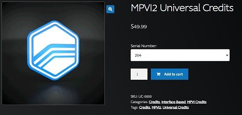

    2) Adding credits to your MPVI2
    As previously mentioned, there's a number of ways you can go about getting credits for your MPVI2. I'm going to outline things going direct from the source, on HPTuners web page. You are welcome to use any of the other methods, but for the sake of this FAQ and brevity, I'm only going to focus on this basic method.
    Log into your account and go to your device (as outlined above) and click on the "Add Credit" button. This will bring you to a page where you can purchase credits. Ensure your serial number matches the number on the screen. Any error here will mean you purchase credits for someone else's device! Add the number of credits you wish to add (remember, we need 4 for our applications) and "Add to Cart". Complete the checkout process.
    Once your purchase is complete, the HPTuners servers will allocate the credits to your device. However, before you can use them, you need to sync your device with the HPTuners servers. Here's a short clip from HPTuners illustrating the process:
    Once you've resync'd your device your credits have now been applied to your MPVI2 and you can use them at this point. Remember that you use your credits when you "Write" a tune back to the ECU. See the "Writing a tune" section above.

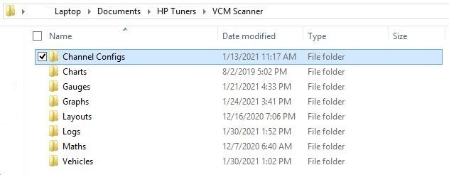

    When configuring the VCM Scanner or doing any datalogging, it's important to know where the various files you're modifying and/or saving are going. The main location that you need to be familiar with is: /Documents/HP Tuners/VCM Scanner/
    Within this directory, you'll see a number of various folders. The ones you immediately need to be concerned with are the "Channel Config", "Layouts" and "Logs". The others are important too, but these are the bread and butter and managing/using the contents within these folders will enable to tuning process to happen.

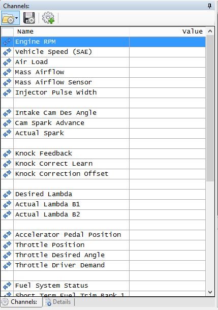

    Channels Configuration
    We've already touched on the Channels Configuration file. This is the critical piece, as it is what the tells the scanner what PID's to poll from the ECU. Without properly loading the proper channels file, the datalog session will likely be an effort in wasting time as the data generated often times isn't useful to making informed decisions on the tuning process. To get the configuration file loaded you'll want to perform the following:
    1. Extract the Techumesh.channels file to (/Documents/HP Tuners/VCM Scanner/Channels)
    2. Once the file is saved to that directory, you’ll open up the VCM Scanner, and then click on the channels tab on the upper left.
    3. That’ll open and you’ll see a list of PID’s that the Scanner will attempt to poll. If you already see that list, you can click on the little folder at the top of the channels list to open the Techumesh.channels file.
    4. Once you select and open the Techumesh.channels file, you should see the list of PID’s repopulate with new parameters. These are the Toyota Enhanced PID’s I mentioned above.

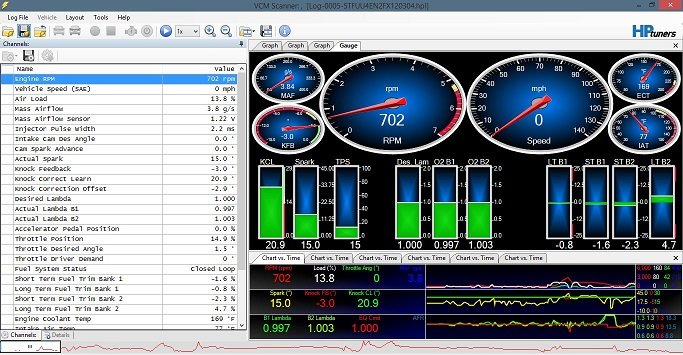

    With the the channels configuration file setup properly, you're ready to start datalogging. To start logging, you'll need:
    1. the MPVI2 plugged into the OBD2 port.
    2. USB cable connected to the laptop*.
    3. VCM Scanner open*.
    * Pro Feature's allows Stand-alone datalogging, no USB/Laptop required
    To start the logging, simply depress the 'space bar' to initiate the log. You'll see the VCM Scanner connect to the vehicle and start polling and recording data. To stop the log, depress the 'space bar' again. You'll see the entire log session remain displayed on your screen. You can review the data or simply press the spacebar again to initiate a 2nd session. You do not need to physically save each individual log (though you can!) as datalog sessions are automatically saved and all log files are stored here: \Documents\HP Tuners\VCM Scanner\Logs
    You may notice that many of the gauges and graphs on the right half of the screen will not report data immediately after changing the channels configuration. This is because the graphs/gauges are all linked to the default channels. Some time will need to be taken at some point to reconfigure those to use the new channels we’ve chosen. (More on that later..)

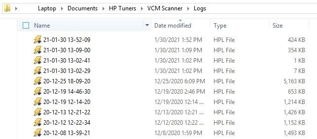

    Datalog Files
    Log files, or .hpl files, are files that have saved frame data. You can save your log files for future reference, or to share with others. You can also export an existing .hpl VCM Scanner log files for external analysis as a comma delimited .csv file. Exporting to a .csv file is convenient if you wish to share your log file with those that do not have HP Tuners. To share your log file with those that do have HP Tuners, all you need to send them is the .hpl file and they will be able to open up the log file in their own version of HP Tuners VCM Scanner.

    Hoping you all can help answer an MPVI2 question for me.
    I borrowed an MPVI2 from another member so I can do a tune soon. But when I made my account on HPTuners, they tell me that another user owns the interface. I had no luck finding an answer on their forums. Wondering if you all know how to work around this? Do I need his account login to use his MPVI2? Or hit up support at HPTuners?
    Thanks!
    JustDSM[OP] likes this.
  19. Dec 28, 2021 at 1:41 PM
    #19
    JustDSM
    JustDSM [OP] Oderint Dum Metuant
    Jan 16, 2015
    #146525
    3,202
    Justin
    Ogden, UT
    2023 Ford Raptor
    If the ownership of the MPVI2 been transferred, you'll need to contact HPTuners Support (https://support.hptuners.com/hc/en-us). Ultimately, the original owner of the MPVI2 will have to delete that device from their account so it can then be registered under your account. All of the existing licensing will transfer, as that licensing information is stored on the MPVI2.
    If this is just a "borrow" to do the tune, you'll have to work out arrangements with your friend to get the necessary credits added to the device.
    Does that make sense?
    1slow4.0, gpdx and scootter82 like this.

    I appreciate your help! That makes sense and is kind of what I suspected. I'll talk with the MPVI2 owner about the best way to use it.
    Follow up question- will my ability to change the tune be tied only to this device? Not that I foresee making changes, but would like to know for the future.
    Thanks!
