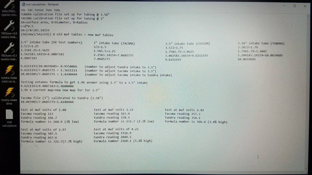

    You guessed it! The connections aren't the same. So I got a Tundra pig tail and Tacoma maf extension then cut an end off the extension and soldered them together + shrink wrap. I clearly did it wayyyy too long but my girlfriend says better too long than too short.

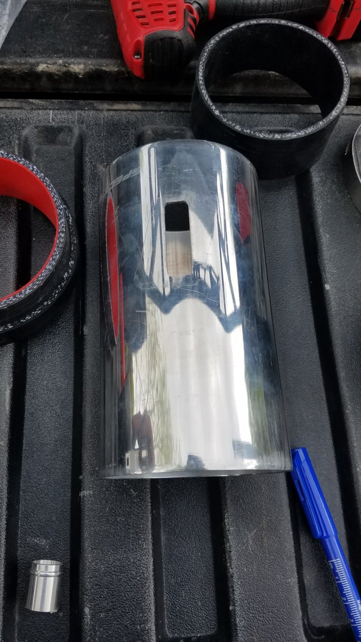

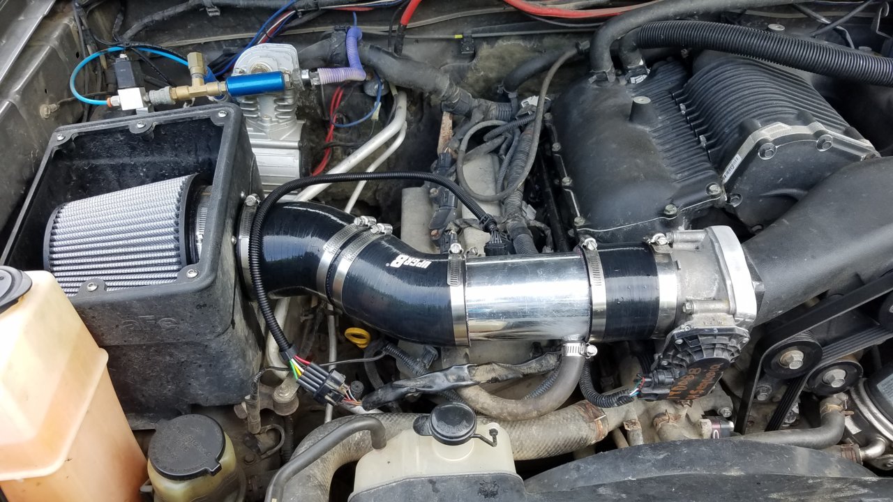

    So in order to make this work I ended up getting these parts:
    Tundra maf sensor.
    A Tundra connector pigtail from ballenger motorsports part# Conn-85788
    Tacoma maf extension harness.
    4" to 3.5" 45° elbow silicone coupler.
    3.5" 45° silicone coupler.
    3.5" straight silicone coupler
    Two 6" aluminum intake tubings at 3.5" id
    5/8" aluminum hose joiner
    3.5 OD Slot Style MAF Mass Air Flow flange adapter for Honda Acura Nissan.
    The 45° couplers needed to be trimmed down some to make them work on the space available. Where they meet is about a 2" long 3.5" tubing inside. I cut a slot out and 1/2" hole out of the other tubing for the vacuum line and to mount the Tundra style maf sensor. Then tig welded them on after cutting the 5/8" hose joiner in half. The wiring isn't direct for Tacoma to Tundra, it's 180° backward. I had to find diagrams of both to make them play nicely. Luckily the Tundra maf sensor has numbers 1-5 right on it which confirmed my diagrams.
    Thanks to @Roostfactor for the Tundra maf calibration file. Him and myself have both measured Tundra intakes at 3.58" id. Since 3.58" tubing isn't readily available I ran the calibration file without modification to see how it would run on the 3.5" tubing. It does in fact run rich so next up will be to take the Tundra maf table and plug it into the equation @OVTune shared back on page 25. End result would be to take the tundra maf tables and multiply them by 0.95580 to make it play with aftermarket 3.5" tubing. I will test this out soon to confirm the numbers.
    Interesting to note is that following the same equation when taking the Tacoma tables (3" tubing) and applying the formula to try and get it to match the factory tundra tables showed up to 7% difference in the formula number compared to the actual Tundra numbers. Because of this, I would suggest using the Tundra tables and not the Tacoma tables to get 3.5" tubing to work as it will be closer to right.
    Cant think of anything else to add at this point. Will edit later as needed.

    DOOOD, thats looking good!
    Is the reasoning for using the tundra MAF because it can measure more airflow? Id figure the stock maf in a larger tube could measure more airflow just as easy. But it would make sense using the tundra maf as tables are already known for a larger tube.

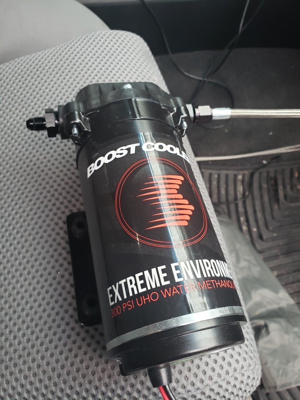

    Cant wait to adjust tuning for this. Yes, 300psi. Snow performance took great care of me on replacement of my pump failure. 15588861986905197860207218809968.jpg

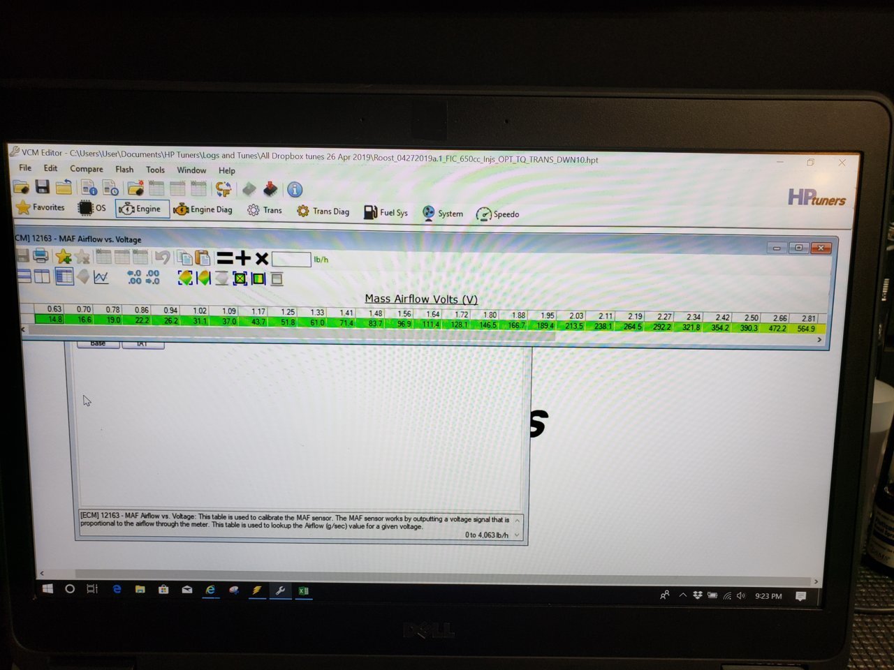

    The tundra MAF does not read more air. In fact MAFs don't actually "read" air at all.
    both the tacoma and tundra MAF are just a 0-5v hotwire sensor. They do the same exact thing. The calibration in the ECU tells what the "air" reading is at a given voltage.
    You can make a Tacoma MAF read whatever you want, or a Tundra maf read whatever you want, just by modifying the calibration (the table) in the ECU.
    You could feed the ecu a fake voltage (lets say.. feed it a constant 2.5 volts) and the ECU takes that voltage > references the MAF scale, and says "hey this is 122 g/sec"
    Whatever you guys do don't try to swap newer tundra or newer tacoma sensors. They are frequency based, not voltage.

    This is true. The reason I went with the Tundra maf sensor is in the thinking that it was designed for a larger diameter tube. My thinking is I wouldn't want the working part of the sensor to be anywhere but the center of the tube for the most accurate reading (way to one side or on the edge I think would give inaccurate readings). So because the Tacoma sensor is a touch shorter, it isn't reading air as close to center of the tube as the Tundra sensor can. I have no idea if it actually make a difference. Also finding the weld in slot adapters was easier.

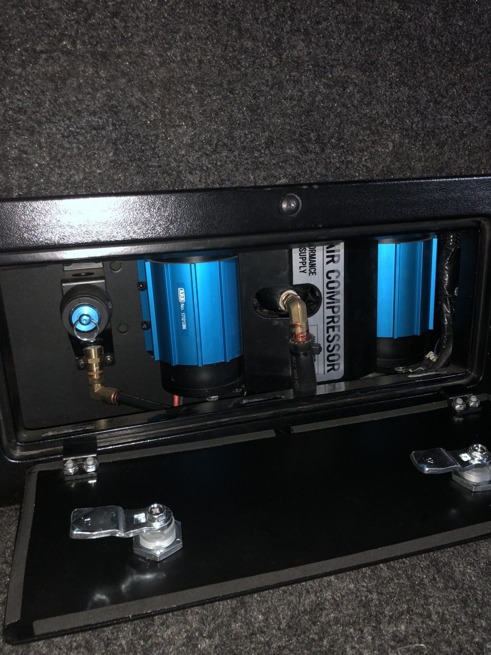

    Which model pump is that and what will you be using it for? Is it on demand air or are you using an external tank? I'm planning to do OBA and haven't been able to decide what parts I want to use.

    Tanks are a waste of time. Takes longer to fill and doesnt seem to help any airing up tires.

    Arb makes a sweet dual unit that mounts behind the drivers bedside cubby hole. @crashnburn80 has one.

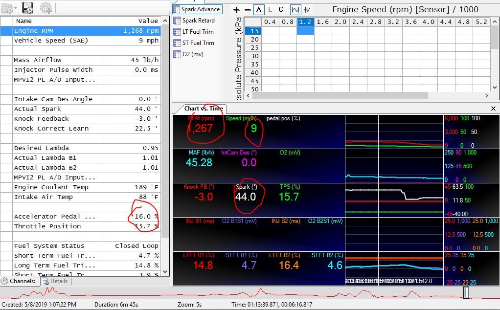

    Hey Manual trans guys.

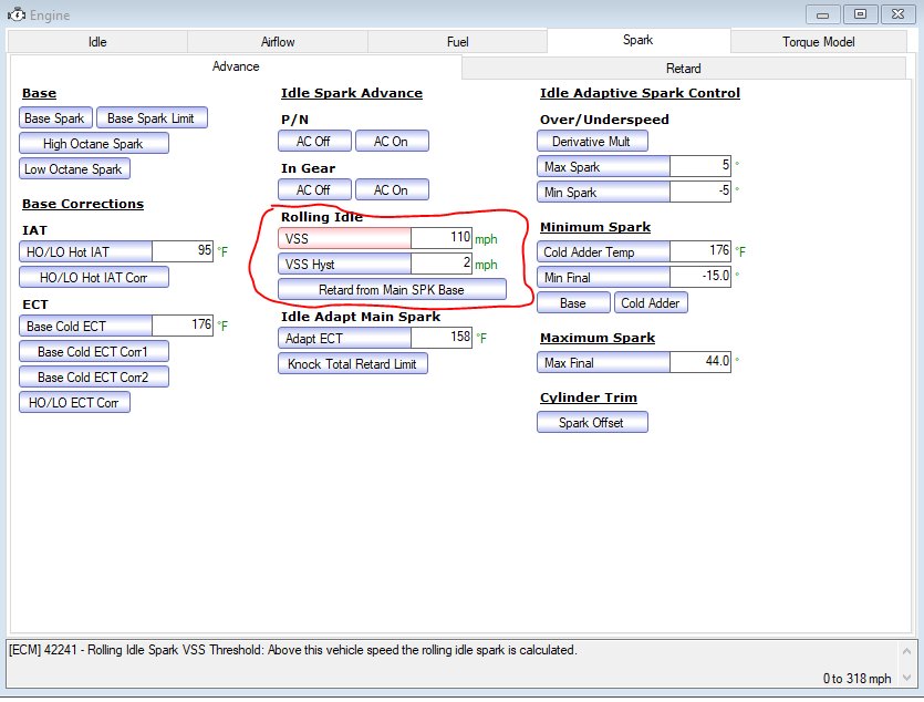

    So, I've been staring at some of my logs and making a few changes here and there preparing for my first flash attempt.
    It seems like the times when the rolling idle speed (causing rev hang) is way up, the timing is also way up. Now, I haven't come across any VSS / airflow tables that would account for this. But I did find this:
    Originally set to 9 mph; My theory is that setting it way up there where I "never" drive will help / eliminate this issue.
    Anyone played with this yet?

    I don't have a manual, but I suggested this to a couple people previously and have heard that it doesn't help.
