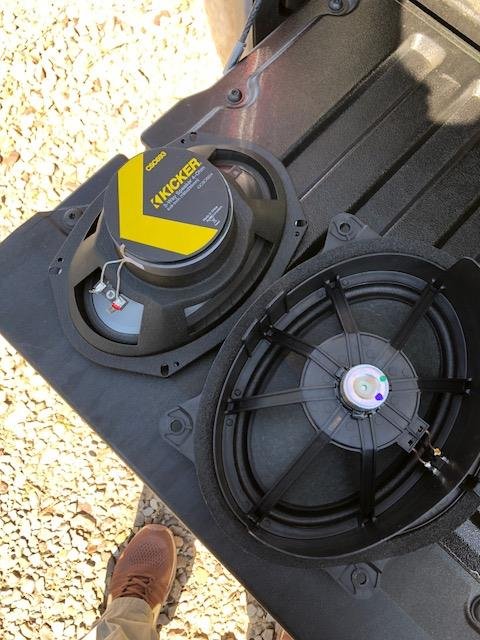

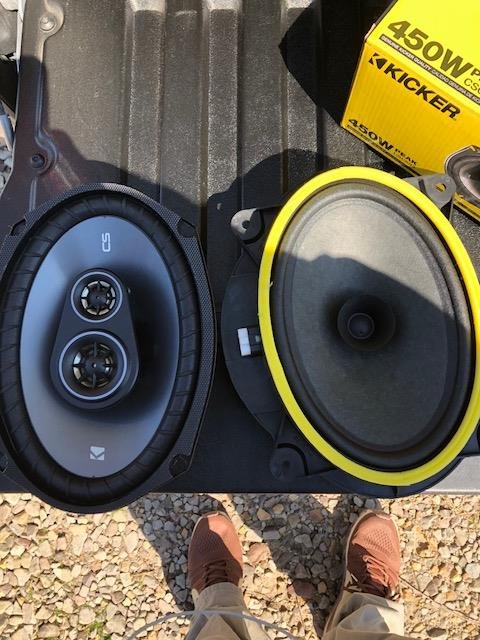

    I definitely recommend Crutchfield.com. They're always my "Go To" for component speakers.
