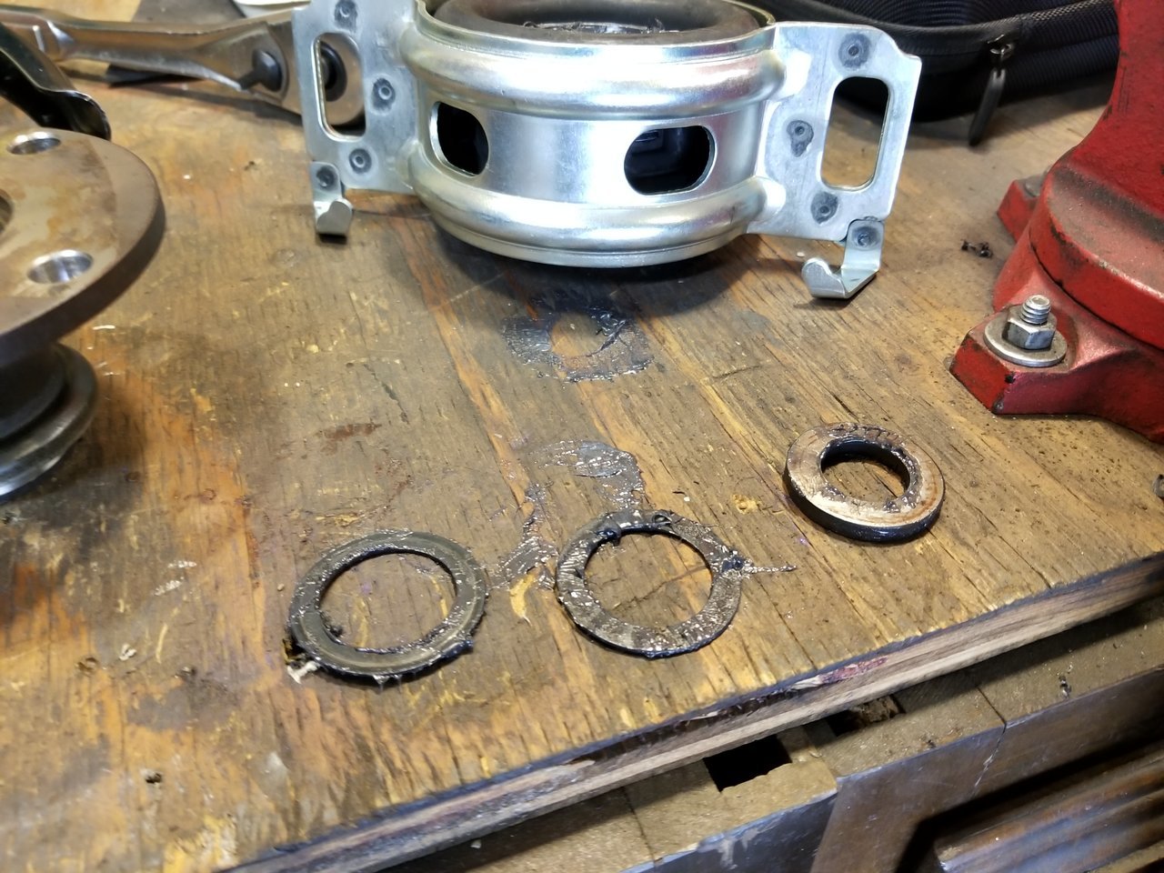

    Where do the washers go? What order? I see 2 thin and 1 thick.....

    You know where the washers go?

    Not sure which washers ur referring to?

    Csb should only have lockwasher for mounting bolts I believe

    I don't recall seeing those thin washers, but I believe the thick one was for the staked nut, I would imagine by the looks of them that they were on either side of the bearing itself. Don't go off what I say though id look into it more

    Think I got it figured. They go on pretty much one way for it to work. Thank you though man

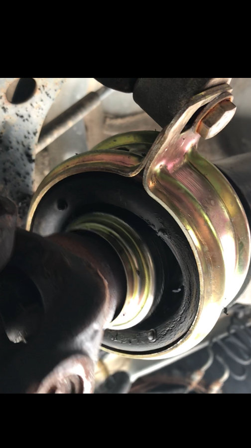

    CF552F5A-C4CB-4C94-B140-7777038ABF1B.jpg 3CE5D3A0-AB73-40E9-800D-338E1C4B6B1B.jpg
    You can see how bad it was , took me only 6 hrs :confused::frusty: but end result so worth it runs so much smoother . Now I really can feel my balls joints that I been putting off :help: . My truck is lifted 6 inches plus body lift I think I’m purchasing a shim kit for my rear and to help mke the carrier bearing last longer and it don’t help when I’m always loading the shit of it
