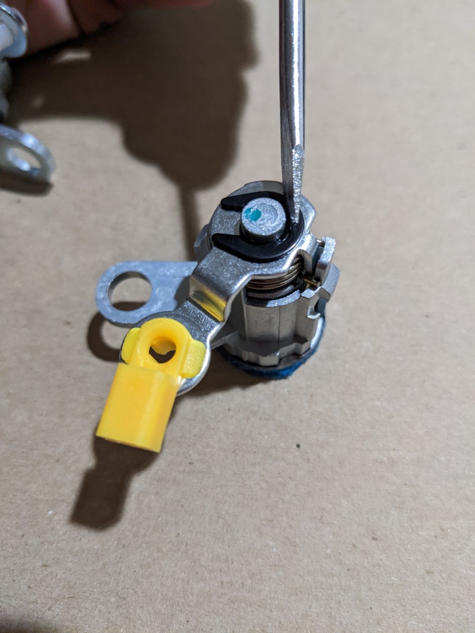

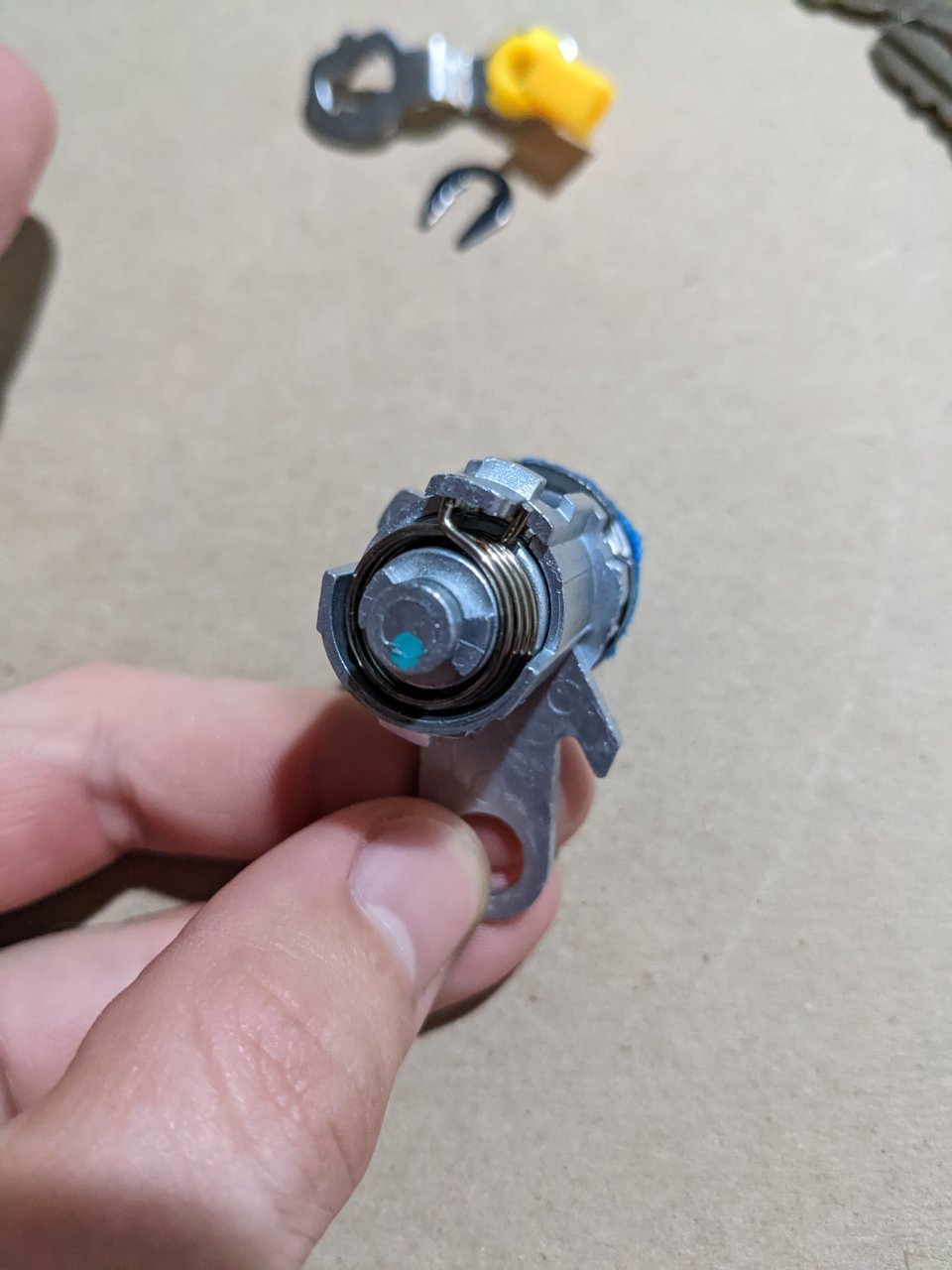

    To get the cylinder out, remove black retainer ring off the back followed by the indexed lever, and clock spring:

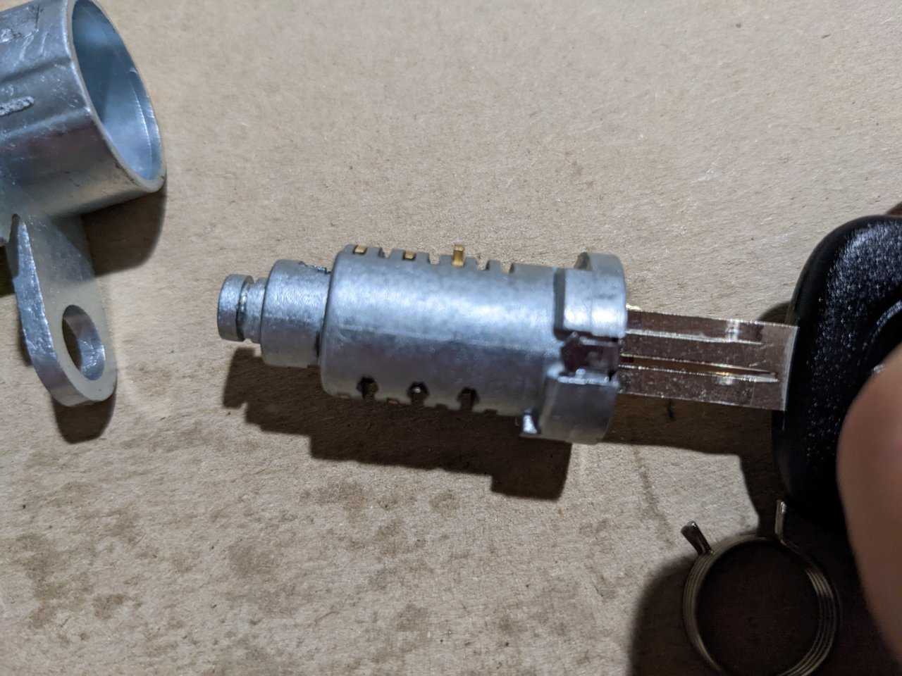

    With the front bezel removed and the correct key inserted, the cylinder can be pulled from the housing. Be sure to remove the cylinder with the key in place, its what is holding the wafers in the cylinder. (Notice the brass wafers flush with the cylinder. This is what they should look like with our desired key inserted)
    With a good workspace able to catch small parts, you can now remove the key and start removing the individual wafers with some needle nose pliers. Each wafer will have its own spring that presses on it. The springs don't have to be removed but can easily fall out and be lost so it may be better to remove them with the wafer. Up to you.
    With all of the wafers removed from the cylinder, now begins the guessing game. Start rearranging the wafers (ensuring it has a spring to engage it) and inserting the new key until each of the wafers is flush with the cylinder when the key is inserted. Here you can see I have 2 correct but one is wrong:
    Once you either get all of the wafers in the correct order (or have extra wafers that do not fit any slots), you can begin reassembly in the reverse order of disassembly.

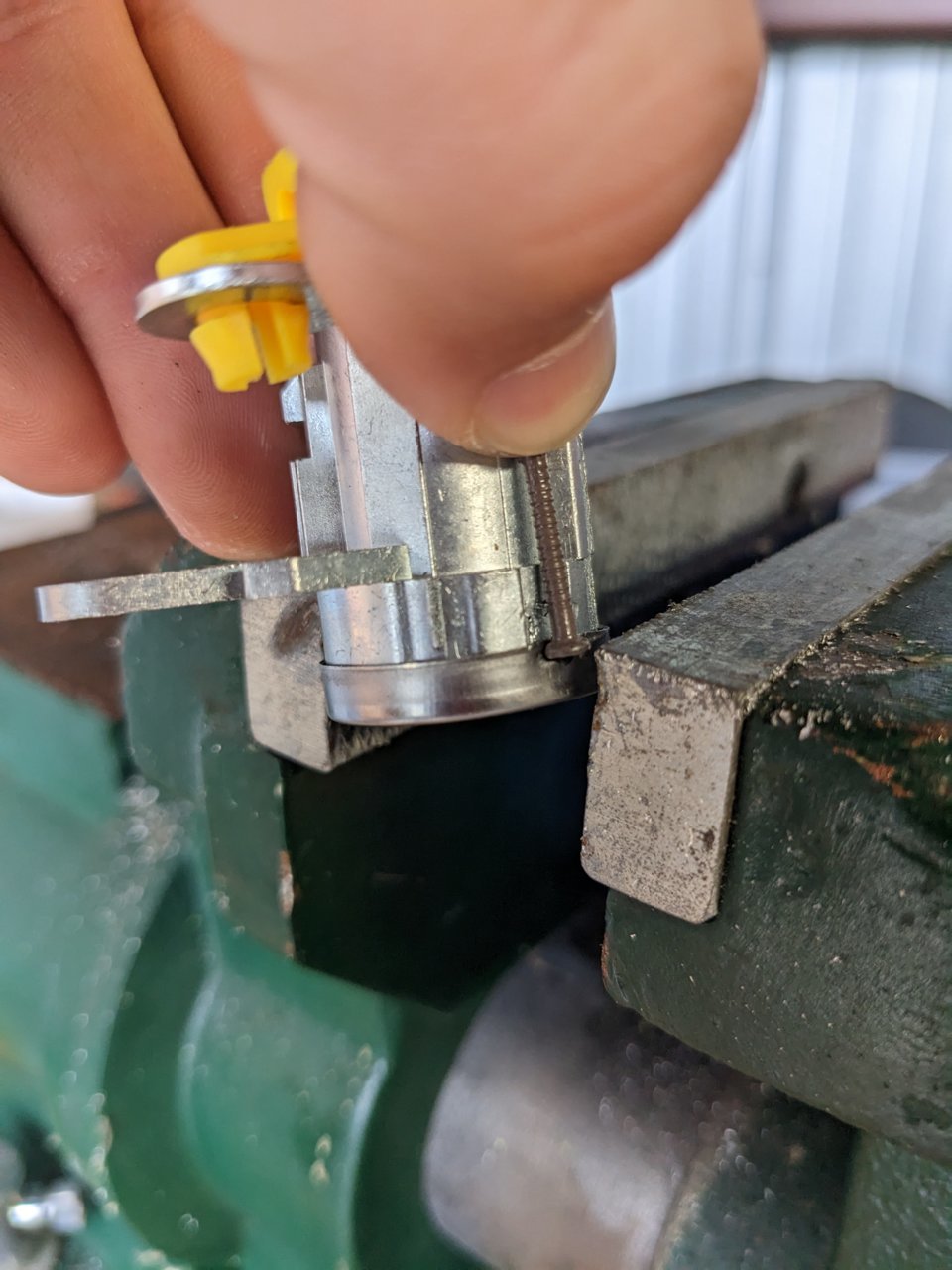

    For reattaching the bezel, I found using head of a small nail and a vice worked pretty well:

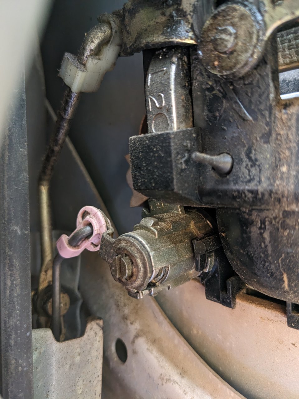

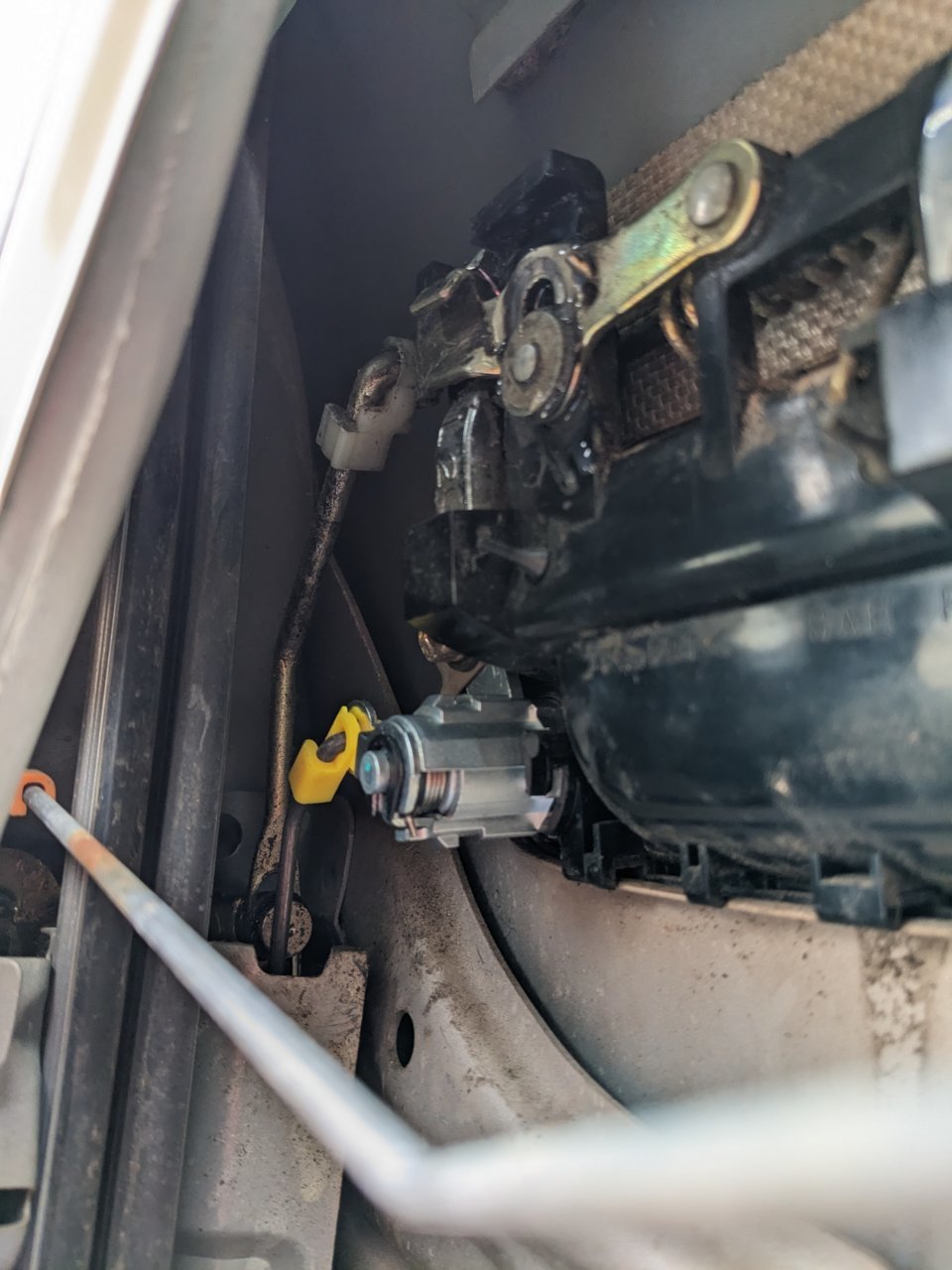

    With the door panels off, you should see the door handle attached with 2x 10mm fasteners, and 2 wire linkages (with plastic retainers). You have 2 options to proceed:
    1) If you want to remove the entire handle for cleaning and re-lubricating (a good idea), you will need to remove both linkages and both fasteners. With the handle removed, you can easily swap the new cylinder with the old
    2) If you don't want to bother with removing the handle, you can replace the cylinder with the handle still in place. To do this, remove the lock cylinder linkage, its fastener, and loosen the other fastener holding the handle in place (but don't remove it completely). From here, there should be enough room to twist the old lock cylinder out (its held in by a small black plastic tab in the pic below. To remove, twist clockwise) and twist the new one back in its place. Be mindful the tab of the cylinder goes between the door handle and sheet metal of the door. Then just reinstall/tighten fasteners and reattach the linkage.

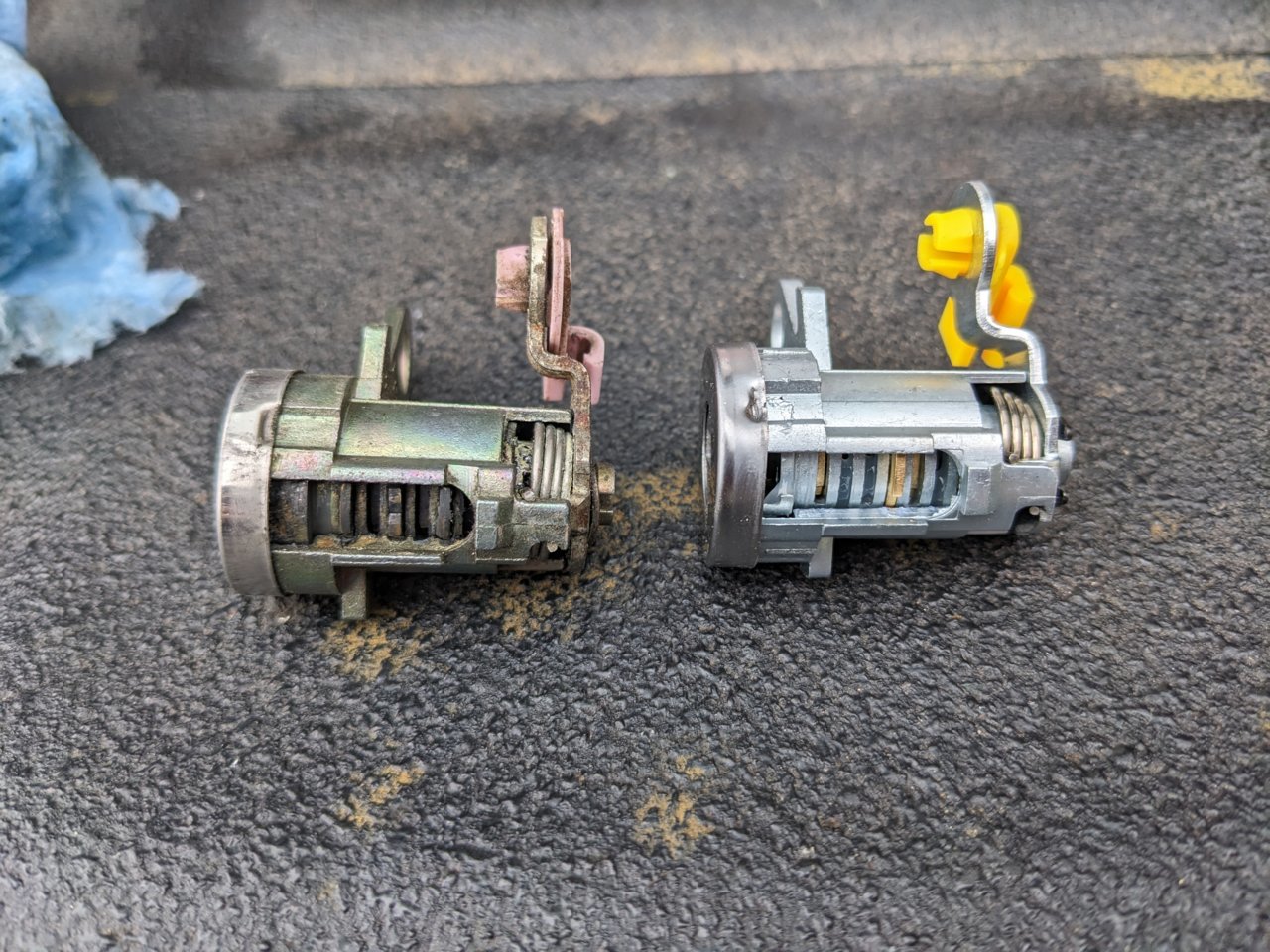

    Comparing the new and the old cylinder, it seems obvious why the old one was binding so much. I may clean it up to see if it returns to functioning normally to have as a spare, but hopefully the new cylinders last me another 20yrs:
