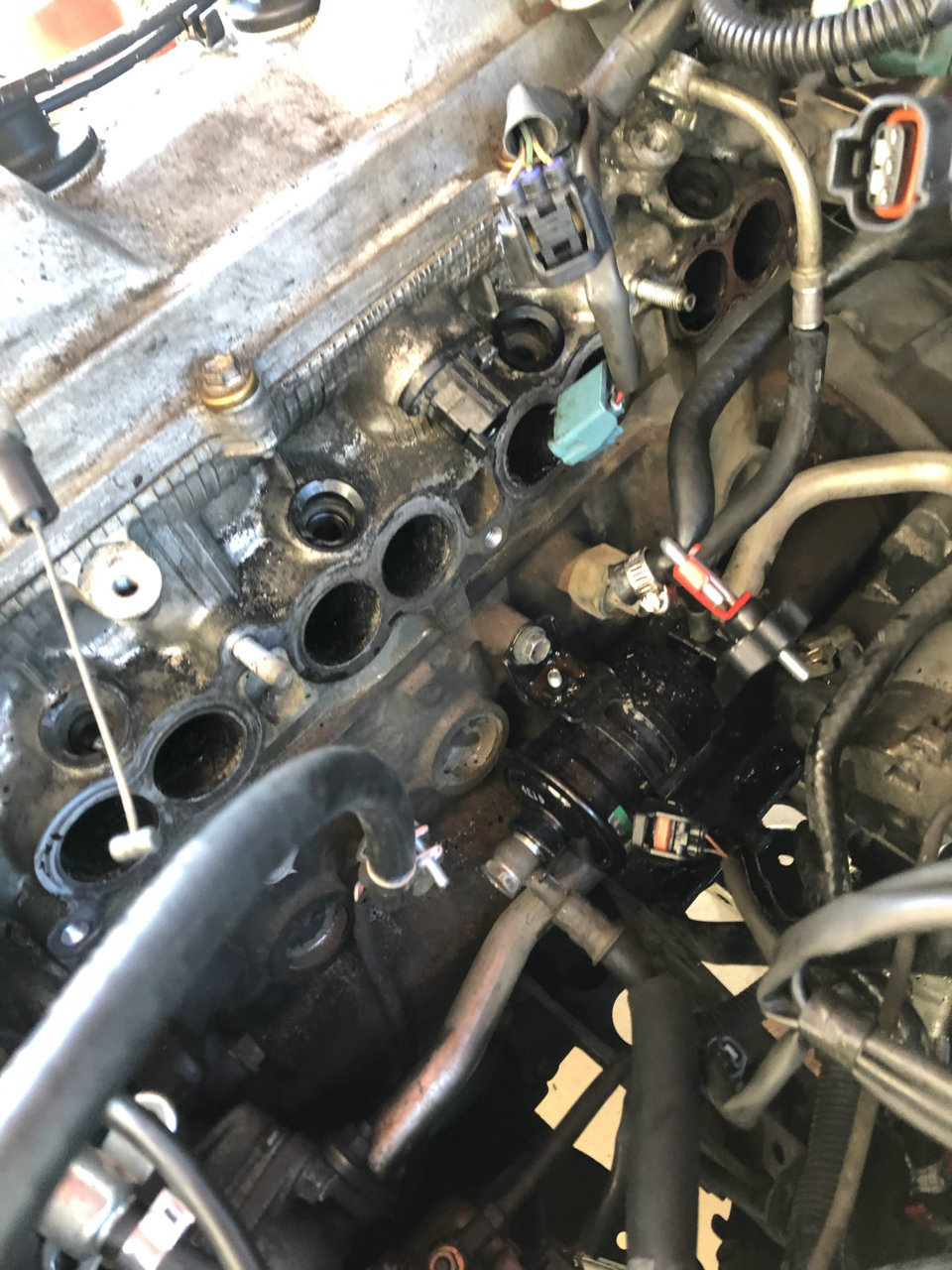

    Alright so I took the upper & lower plenums off and low-and-behold have I got a mountain of carbon build up on these suckers.
    I tried going at it with a small pick and my shop-vac but it's barely doing a thing. Ports are too small to stick a brush into...Are there any products that are safe to spray into these intake ports? What are some good ideas of getting this gunk out safely?

    Pull the PCV valve and check if it's constantly open.

    I have a diesel mechanic friend who said don’t mess with the carbon since it may fall onto the pistons, and that this doesn’t look that bad. I’m tempted to still clean it up though.
    If I had known I would be pulling my intake out I would have waited until now! I changed it already through the wheel-well recently haha

    Regarding the injector cups, I used a 12" long bolt that I modified into a cup puller. Don't remember the diameter (might have been 3/4"), but it was just big enough for the threads to bite the inner walls of the cup. I tapered the end and cut two grooves in the threads, so that it would function like a big self tapping screw. I sprayed some penetrating oil around each cup and let it soak in. Gently screwed the modified bolt into each cup a bit and wiggled and pulled until the cup released. It worked pretty darn well. I can post a pic of the bolt if you'd like.
    I also cleaned my intake passages of carbon build up. Mine were much worse than yours. I fabricated a sort of hooked scraper with a radius end that matched the intake. I'd stick it in, not touching anything, until it was past the carbon gooo, then pressed it against the intake wall and pulled/scraped the goo out. I don't think much fell into the intake and I wasn't too concerned if it did, as I figured it would either burn up in the combustion process or get blown out on the exhaust stroke.
