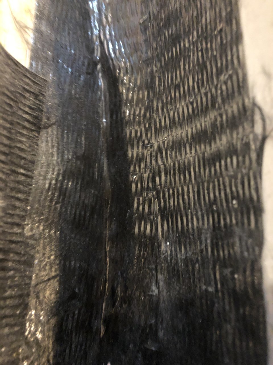

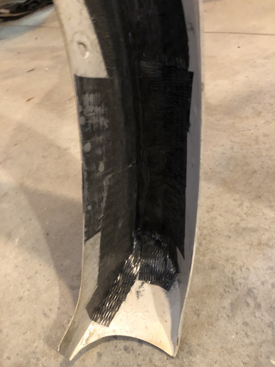

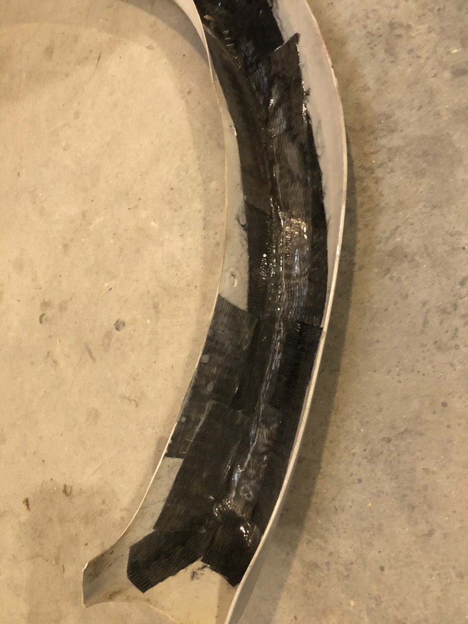

    Lots of 6-8” thick long ones. Use lots of lube. Lube it up before you apply your 6”-8”, then really soak it agin when your done. Go both directions as well, variety is good. Overlap as often as possible.
    what’s everyone laughing about?

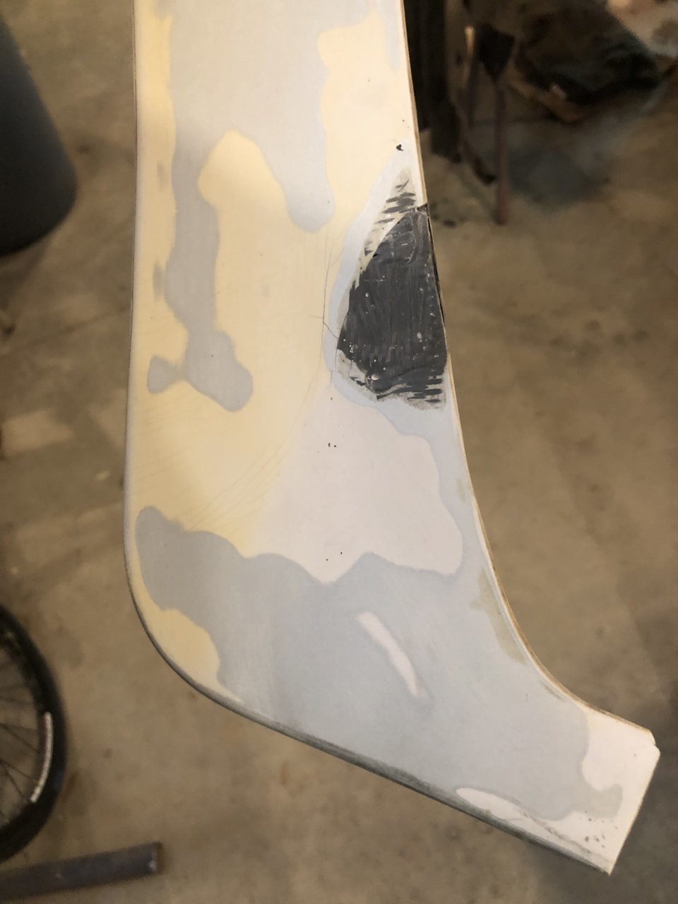

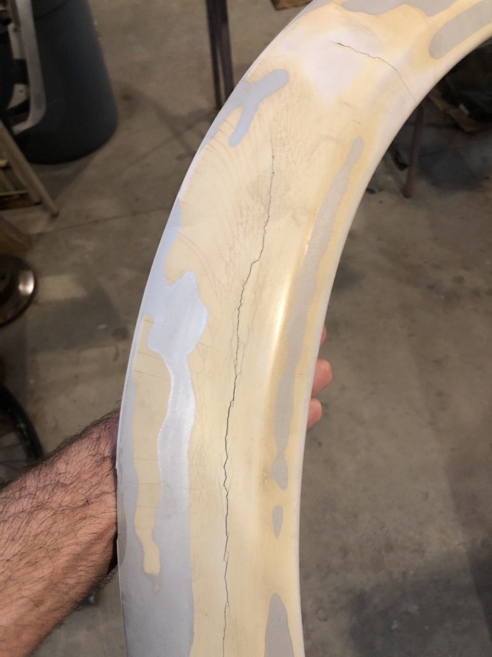

    here are pictures of mine. When your done sand the face smooth to get rid of any ridges. Gonna need maybe a skim coat of filler (I did not) or lots of primer to fill any cracks. I don’t know. My body work sucks.

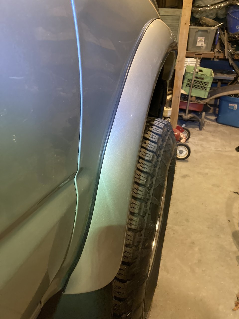

    Thought I would post a photo of the repaired painted and mounted fender flare.

    Looks fantastic!
    Whats the material of the fender flare? Id recommend plastic welding if it's plastic.

    the fender is fiberglass. Plastic welding is a great suggestion. Thanks.

    ahh no wonder it shattered. your body work is so good you can't even tell there was a repair :thumbsup:
