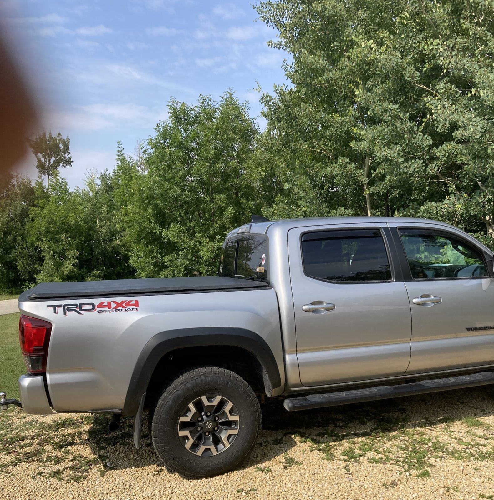

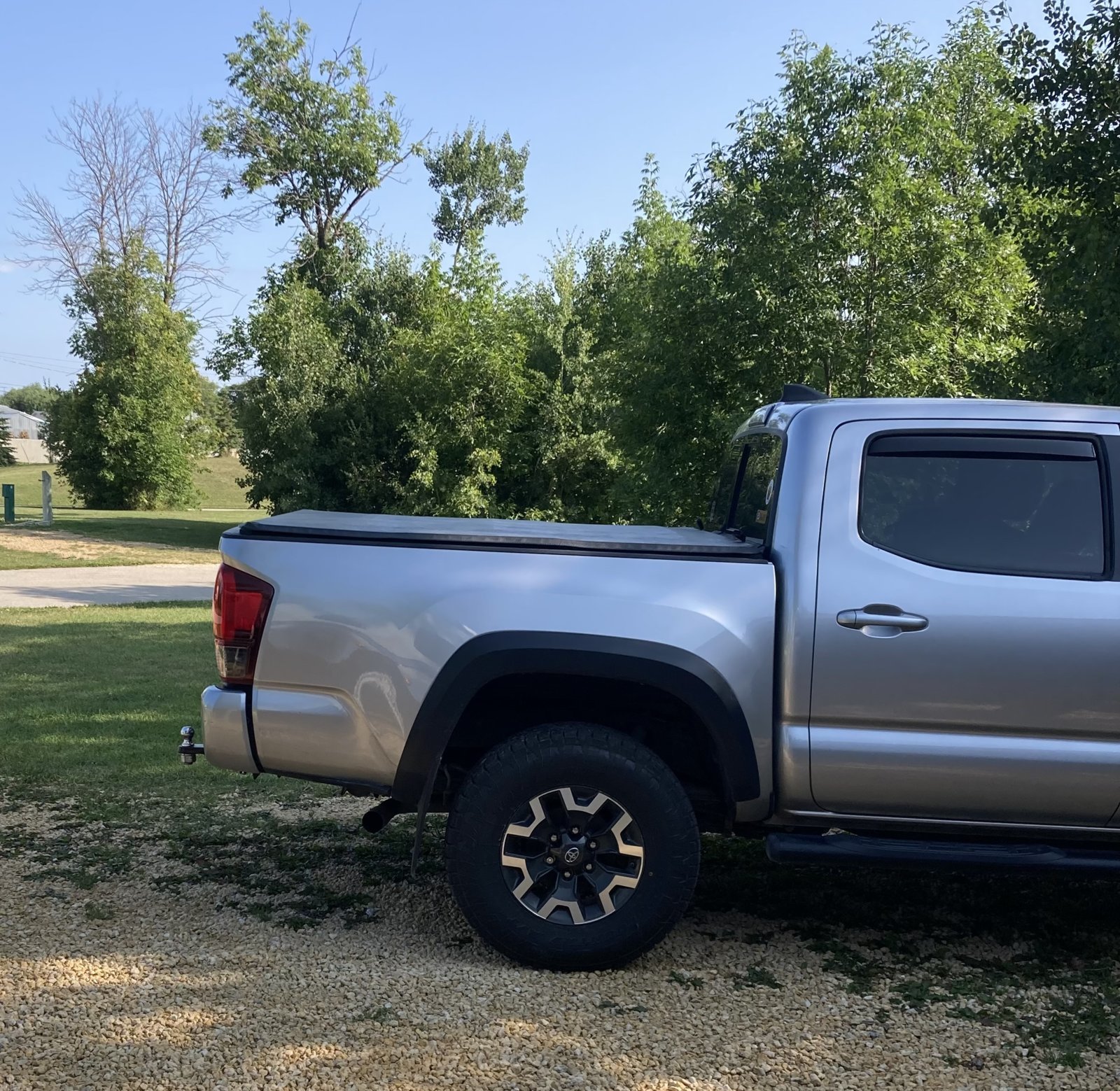

    Warm up the area, (out in the sunshine around noon hour was good for mine). The decal should peel off. Mine had been on the truck for five years. WD40 will clean up the residue and a little wax to shine it up. No ghost outline.
    Before
    After

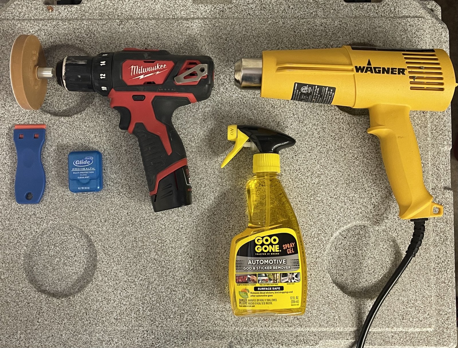

    the eraser is a game changer, this is what I used.

    I’ll go and take a real close look at mine right now. I’m fairly sure There’s no ghosting but I’ll go check …..

    … No ghosting, no nothin’. Mine is Silver Sky Metallic, your colour might yield different results. Best.
