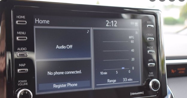

    Today I was playing with Alexa and installed the Toyota+Alexa app in the car via the Entune app, now every time I press the Audio button Alexa gets launched, I didn't find an option to remove, is there a way to do it? Thank you

    I did the samething but I was able to remove the toyota+alexa app.
    1. You need to reinstall entune 3.0 and toyota + alexa on your phone.
    2. Make sure everything is connected including your bluetooth with your screen console. You should have all apps running.
    3. Then click "APPS" on your console (above the tune scroll) select toyota+alexa and delete the app.
    4. Disable toyota alexa app on your phone.
    This will remove toyota+alexa app.
    Check the screen shot in the attachment.
    Hope this helps.

    I was facing the same issue and this worked for me. In the home screen, press the top left tile and then it will show you different options of source of music like "Bluetooth", "FM", "AM", etc. PROBLEM SOLVED !!!
