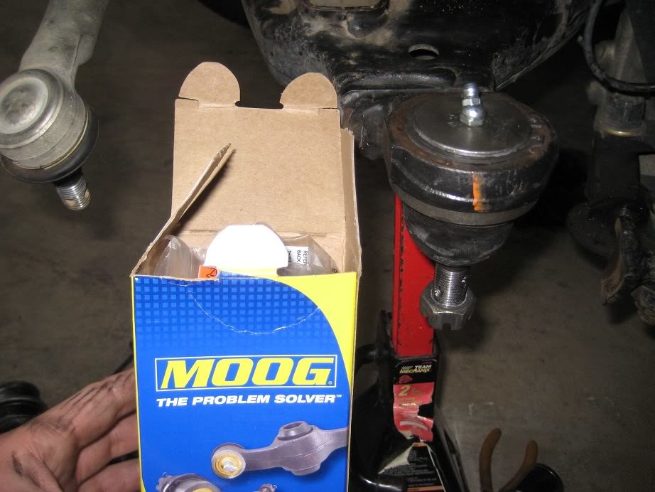

    I would have done a write up on the subject, however I used methods that no civilized man or woman should use. And by that I mean modifying tools and a fair bit of cussing. Oh well... Got the job done!

    In retrospect yes. There simply isn't a proper tool for removing a lower ball joint from this year of truck. I'm not too excited about removing the lower control arm either but if you mark where the caster/camber adjusters are and install it the way it was removed after you visit a shop with a press, then you shouldn't experience any challenges.

    mine was a pain in the @ss i didnt have my truck for 3 days (working on it after work) i replaced all 4, to top it off the boots tore putting them back on so i hope it doesnt dry out..and that was a pain also.. those little boots would not go on with the clip for the life of me.

    What do you mean the boots wouldn't go on? Are you refering to the upper control arm? I know on the lower arm the boot is underneath while the clip is on top.
    I can't believe you did all of them. What tool did you use to pull them?

    im refering to the boot that holds the grease inside the ball joints. it was so hard and the boots tore a little so far i think they are still holding grease inside.. not to mention the little nipples to put grease in didnt even fit right so in order for me to put grease i have to old a fitting in there
    i used some press and a hammer to bang the ball joints in and out. my friend is a mechanic so he helped me alot. and it was still a pain. hopefully i dont have to do it again anytime soon lol

    YES! Those stupid nipples were a pain in the ass. Apparently moog forgot to thread that shit.. wtf!?
    Oh god don't remind me of the hammer and press. That' exactly how I had to get my ball joints out. Those things were pressed in like nothing I've seen.
