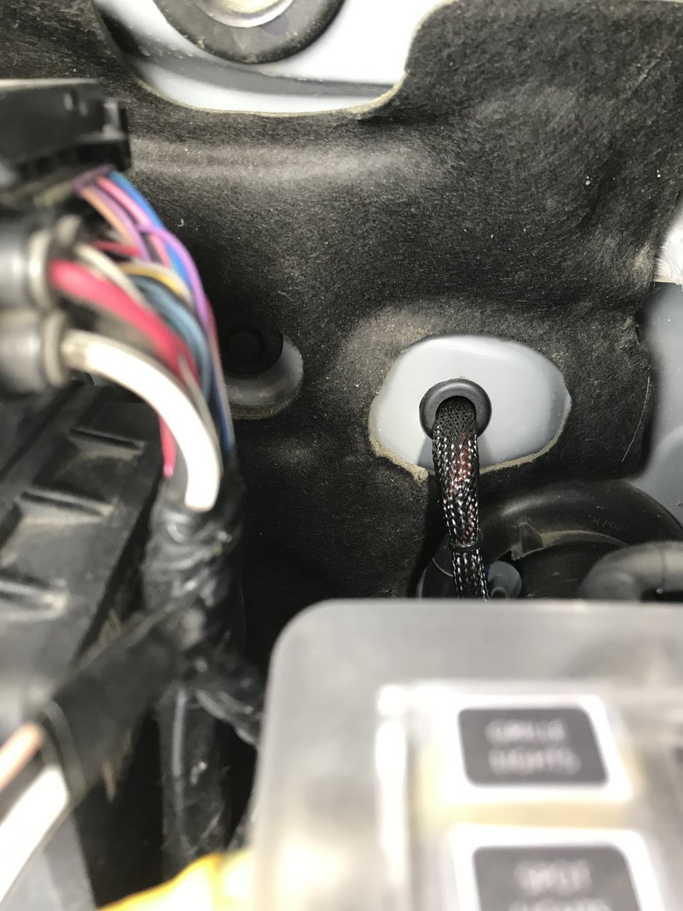

    No need to cut, drill, or destroy anything, just use the factory provided sleeves (boots) thru the fire wall, clip the blank tip, run wire and securely tape to remaining boot.
    Passenger side firewall
